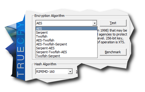

Well it says an 'unnamed algorithm' rather than another program. Truecrypt offers a number alternative encryption algorithms as well as cascaded combinations.
Obviously one can't be sure but I'd sooner guess that it was simply one of those, after all rolling your own crypto algorithm is never a good idea.

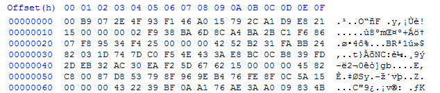

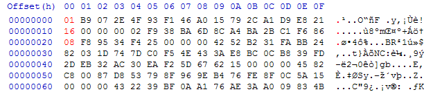

One old technique is to intentionally corrupt the encrypted file in a reversible manner. All you need to do is open the encrypted file in a hex editor, change one or more bytes using some arbitrary schema, and save it.
Example: After encrypting, add 1 to the first byte in the first three rows.

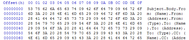

Original file
« Last Edit: June 28, 2010, 08:06 PM by 40hz »

I didn't know about that 'purposely corrupting some bytes' trick. But wouldn't you be better off putting that effort into remembering an even stronger password? Seems to me like changing some bytes is like an extension to the password.
Also a question about the effect on the data? I know RSA and probably those like it would succumb to any changed bytes, but wouldn't the like of AES decrypt up to the corrupted portion more or less correctly? Thinking about it, if there is more than one pass over the data then no you probably wouldn't be able to recover anything.

I may be misunderstanding something -- I'm not an expert on cryptography. But from what I understand, I believe that
Since encryption algorithms depend on every byte in the encrypted file being correct, any change anywhere in the file makes decryption impossible.
Is not true. I believe that the cypher's block size describes chunks of data for which this is true, but corrupting one block won't affect the decryption of the others.
Indeed, something at least similar to this must be true for SSL to work: you can decrypt the beginning of the stream without knowing the end (since it hasn't been received yet), and a transmission error early on doesn't force the connection to be discarded and reestablished because it's become corrupt.
However, trashing the header of your truecrypt archive may make it so that truecrypt is unable to open and mount the file.
That said, it still doesn't ensure your security in the most extreme conditions. Just because TC itself can't open it doesn't mean that the spooks can't accomplish the same thing. If they can access every other block successfully, then what they've got probably looks like a (virtual) disk with a corrupt MBR, which isn't going to be too much of an impediment.
Really, what you're proposing is only a simple additional layer of security that, once the bad guys discover, offers you no protection at all. Your accomplice could rat you out and you'd never know it. You could probably more easily achieve the same effect just by storing your data in some non-traditional way (say, using SoftMaker or KingSoft native file formats rather than Microsoft's), so that the bad guys don't recognize it. It's not much protection, but makes it a bit harder for them.

CWuestefeld - I think there is a stage input from one block to the next, so a corrupted byte in one block would probably also corrupt the blocks that follow it. At least that's the SSL approach I believe. Truecrypt supports random access so probably does thing differently.

Eóin: salts are prefixed to your passphrase, to make brute-forcing slower, thwart rainbow-table attacks, and make hashes of identical passwords different. Making samedata+samekey look different is handled by an Initialization Vector (nonsecret, just as salt is).
40hz: as others have mentioned, changing a few bytes won't corrupt the entire encrypted data stream... depending on the encryption mode employed. For ECB mode, you ruin up to the Cipher's block size (128 bits for AES), for CBC mode you ruin more... potentially the whole stream, but systems supporting random access (like TrueCrypt) cuts the stream into chunks - so you only ruin a single chunk. TC doesn't use CBC mode, btw, but XTS - which I know nothing about. Also, I ran into a paper about error propagation in CBC mode a while ago, and it turns out it's not as effective as you might think; don't have an URL handy, I'll let somebody with better google-fu hunt it down :)
