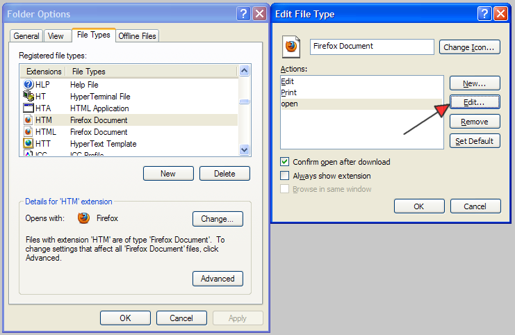

in most cases the .htm and .html filetypes are already given arguments in enclosed quotes like this "%1" (see pic). e.g. "C:\Program Files\Mozilla Firefox\firefox.exe" -requestPending -osint -url "%1". if you don't mind, can you check in the Folders Option and see how it is configured at your system?

I don't mind at all.  I've got
"C:\Program Files\FindAndRunRobot\Farr_Browser_Launcher.exe" "%1"
So, yes, the quotes are there.
I'm using Directory Opus as my file manager and bblean as my shell, but I don't think that would make a difference. I am curious if anyone else has had the issue; but, as far as I know, nobody else has tried using FBL as their default browser. They haven't posted about it, anyway. It's certainly saved me a lot of time not having to wait for Firefox to load up (I have quite a few extensions) every time a program I'm using decides to open a web page.  I don't have any extensions in Chrome at all, so I can use it as my "I want to take a look at something quickly" browser.

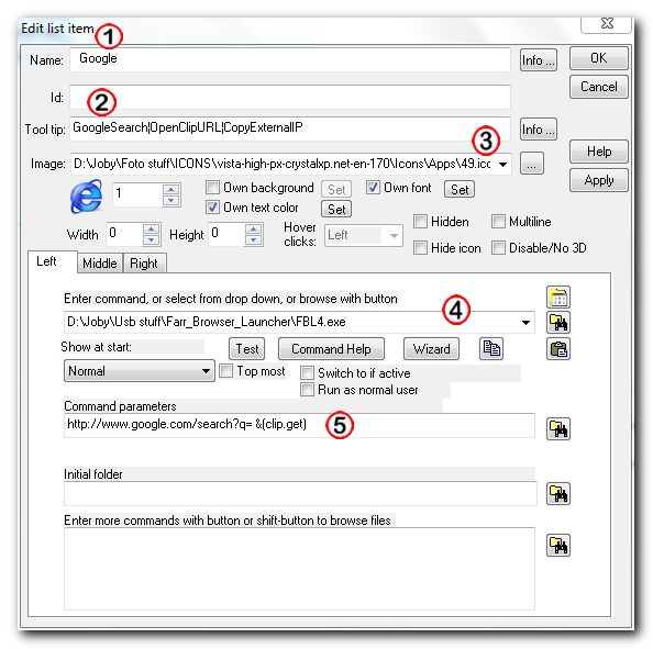

joby_toss
  • Posts: 114
I don't know how many PowerPro fans/users are here, but I will try to mention one way you can use PP (with clip.dll plugin) and FBL together.
Take a look at the image below (you get to that by Ctrl+RightClick on a PP bar -> Configure -> Command list -> Add new before/after (while selecting the desired PP bar).
1- choose a name for your button
2- write the tooltip to be displayed on mouse hover over the utton
3- choose the path for a custom icon for your button
4- enter the path of your FBL executable
5- enter the Command parameters. Examples:
Code
http://www.google.com/search?q= &(clip.get)
for Google search for current clipboard content
Code
http://thepiratebay.org/search/ &(clip.get)/0/7/0
for TPB search for current clipboard content
Code
http://www.imdb.com/find?s=all&q= &(clip.get)
for IMDB search for current clipboard content
Code
http://www.youtube.com/results?search_query= &(clip.get)
for Youtube search for current clipboard content
Code
http://www.thefreedictionary.com/_/dict.aspx?word=&(clip.get)
for TFD search for current clipboard content
If you don't add " &(clip.get)" expression, you'll get to the search page of that particular website (and you can do a regular web search).

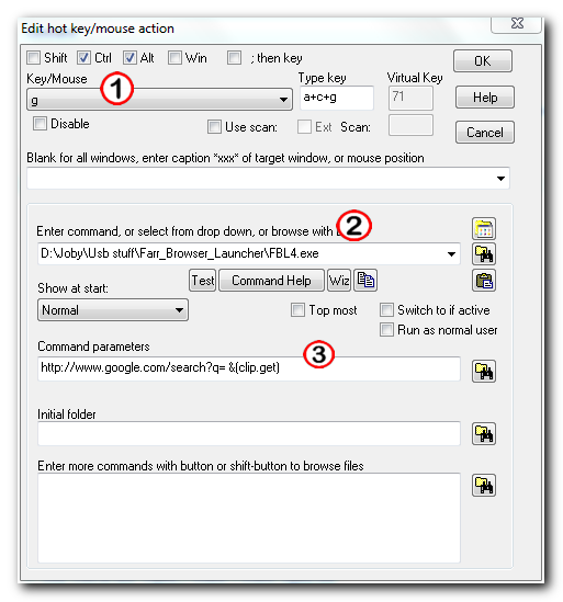

Also, you can do the same with a hotkey instead of a button bar:
