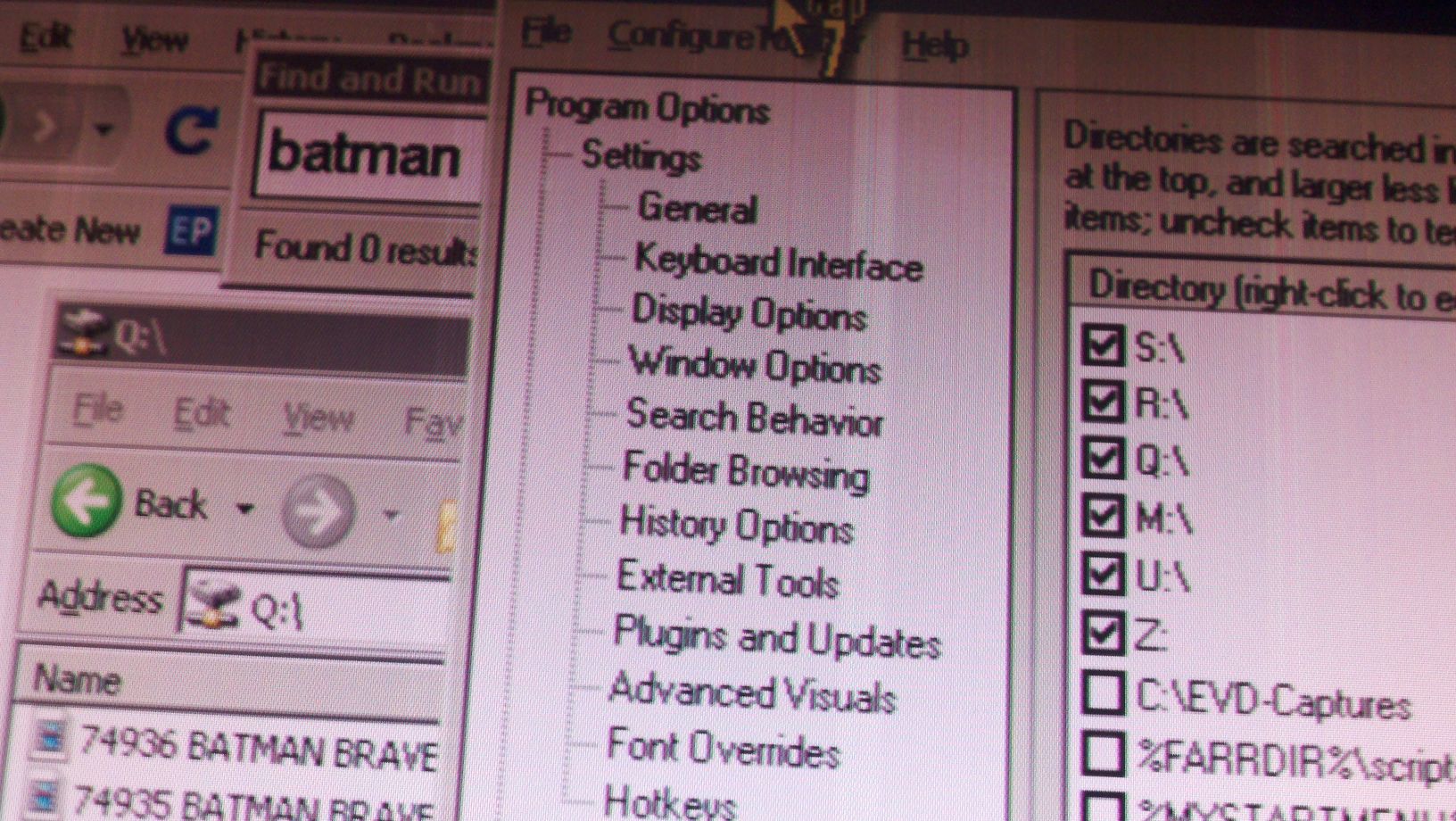

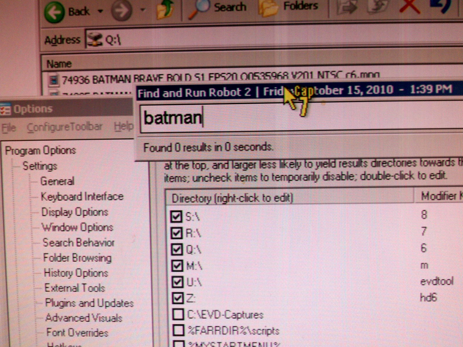

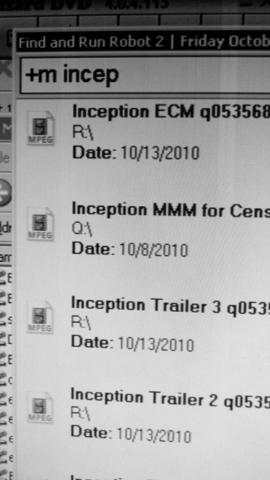

this is the sadness I have... (attached pictures)
in this particular case I don't want to search all m drives... JUST the M drive...

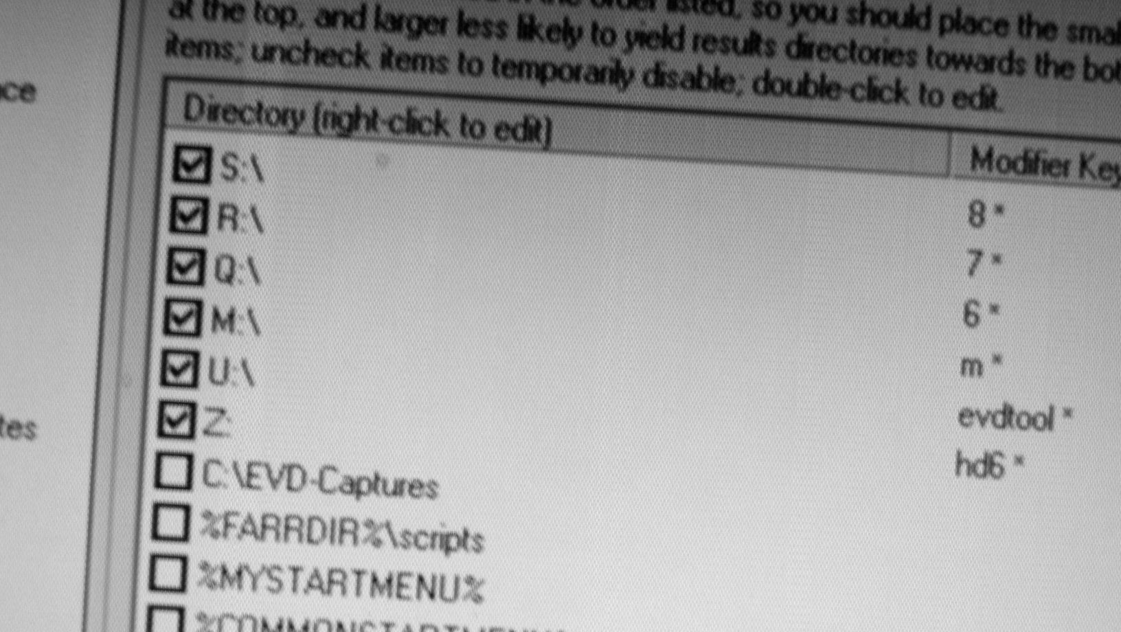

this one shows, all together, my search folder list, the search I'm trying to run, and the file sitting in the drive that should be found
ps: new picture - can't believe I took such a useless first version
pps: the machine with FARR has zero internet connection with my email machine, so I can't take real screenshots
Fear not though - Screen Shot Captor is installed elsewhere
« Last Edit: October 15, 2010, 08:50 PM by dwilbank »

i need to see the second column of your search folder list, so i can see what modifiers you have set.

I updated my picture, but don't know how to trash the old one...
Re: how to specify searching only in two specific folders?
« Reply #20 on: October 16, 2010, 03:36 PM »
you have to add the word "blank" to your Keyword modifier list (without quotes) for a search folder if you want it to be searched by default.
So if you want the m drive entry to be searched by default AND when you type +m then for keyword modifiers specify:
m blank
