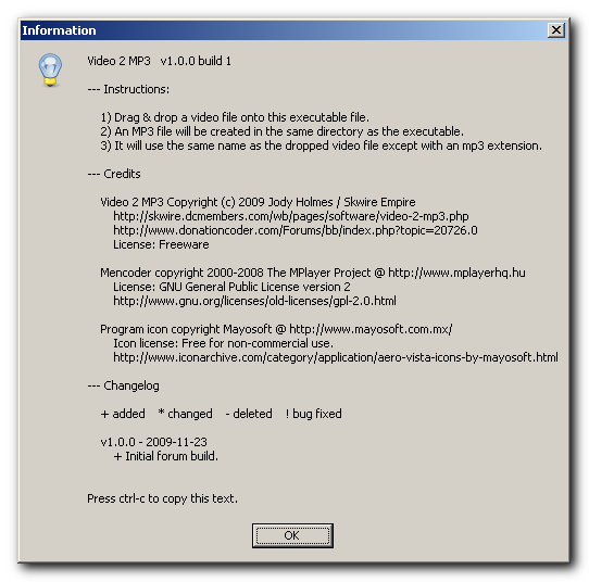

Website | Download
v1.0.0 - 2009-11-23
   + Initial forum build.
Instructions:
1) Drag & drop a video file onto this executable file.
2) An MP3 file will be created in the same directory as the executable.
3) It will use the same name as the dropped video file except with an mp3 extension.
I tested it with an AVI, MPG, and FLV file.  Obviously, the larger the file, the longer it will take to extract and produce the MP3.

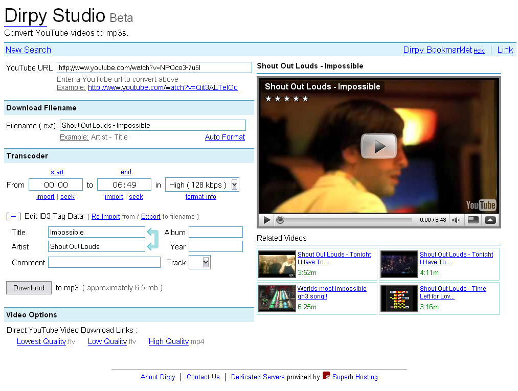

Skwire's coding snack seems like a great solution. If the videos are on youtube then there are also several good webapps. Dirpy (http://www.dirpy.com/ ) is the best one I've found. Very quick and no-nonsense site. Enter the youtube video URL, tweak some settings if you want to (choose a subsection of the video, change id3 information, set bitrate...) and download the mp3.

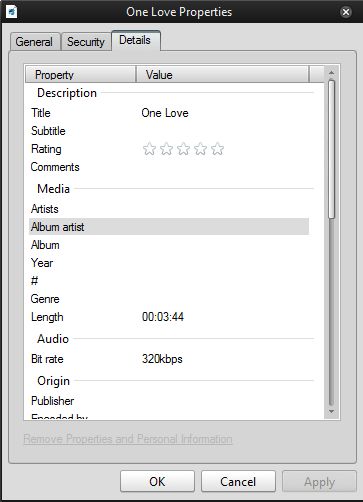

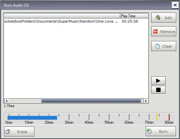

When i convert the video the mp3's length becomes longer than what its supposed to be.
It doesn't show it when i check the mp3's properties only when i try to burn it.
thanks for a great program, very easy to use.
i used Mp3 Direct Cut,so i could fix the length, but it doesn't show the whole 25 min it shows the normal length.
the videos are from youtube.
