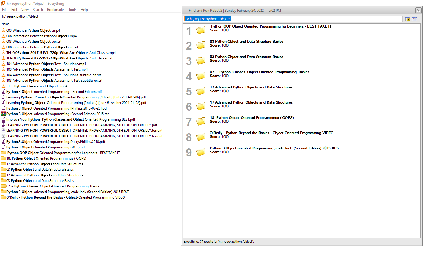

Search Everything vs FARR tinyEV.pngHello all:
Why the FARR Plugin: TinyEV (Everything integration), does not work properly, I compare TinyEV and Everything search, and the results were very different :
I used regex.
Tynyev : 9 items found
Everething : 31 items found
I think this plugin is abandoned, nobody is updating this plugin, so I recommend not use it,  because it gives wrong results.
Thanks
« Last Edit: February 20, 2022, 07:06 PM by tony01 »
In your screenshot, FARR says it has found 31 results (in the status bar at the bottom). Have you tried hitting PageDown to see the rest of the results, and are they the same? FARR only shows the first 9 results of anything, generally. This can be changed in Options→Settings→Display Options→Result Display Size. I wonder if there's a way to get TinyEV to automatically switch to "Extended results list" without pressing pagedown?
I use TinyEV all the time, many times each day, and it has always worked great.
Eric
« Last Edit: February 20, 2022, 09:56 PM by ayryq »
