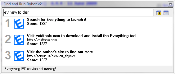

here's a screengrab of what i mean:
as you can see, if i type "ev..." i don't actually get a list of results matching the search term. (there are several "new folders" on my drive.)
do i need to configure the plugin somehow.
anyone have an idea?

Everything is constantly running on my machine by the way, but it looks like the FARR plugin can't see it.
« Last Edit: June 11, 2009, 04:50 PM by nudone »
you need to make sure Everything is running.. if it is, then the problem may be that you are running it as a service.  maybe tell akx where he can learn about this service trick.

Oh dear. If Everything is running as a service, there might be an issue with the privilege and desktop separation in UAC, Vista and services.
I personally have Vista with UAC disabled, so I can't exactly help, other than making sure that the desktop the Everything service is running as is an interactive desktop.

akx, as you can see from Nudone's status bar, it says the IPC service is not running.. do you think the problem is something as simple as TinyEv not knowing how to detect it in this case, or a bigger problem in that there is no way to communicate with it when launched in that way.
akx
  • Posts: 20
Actually, that particular message only appears when TinyEv can't send the query message to the Everything IPC window. I'm not exactly sure why that would happen, though. I'll try and investigate...

Also, nudone: It seems that in UAC-enabled OSes, ie. W7 and Vista, non-privileged programs can not send Windows messages to privileged programs. I'm not sure if you can, or if it's sane at all to set FARR to run privileged, but if you did that, it probably could communicate with Everything.
i can confirm that running FARR "as administrator" allows the Everything plugin to work correctly. So, i'll probably just use this method.
