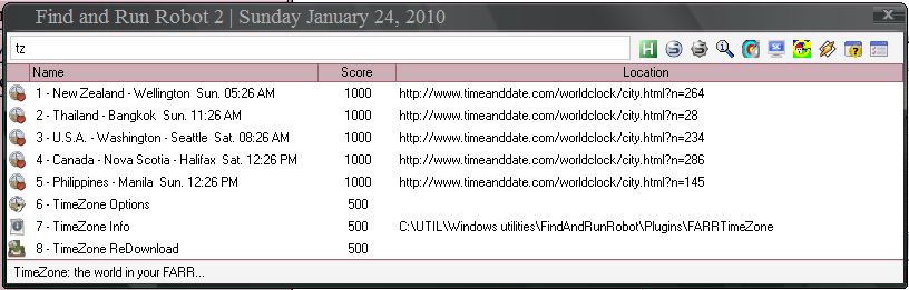

Just reporting that I still can't get this plugin to work properly.
It has to be a bug in the time calculation as it persists in being exactly 12 hours off.
I would make a guess that it is not picking up my system's regional time setting correctly.
Have therefore de-installed the plugin.
Below is a screenshot of the plugin as at 1726hrs (NZ local time).

Hey IainB, sorry I didn't read this earlier.
If you're interested in following this up, can you turn logging on, download and attach the log file.
Thanks

All good. Can I get you to try this version for me: timezone.zip (673.7 KB)
I've included all the possible time formats that TimeAndDate.com use... but this is the odd thing: timeanddate only give me the 12 hr am/pm, but you have 12 hr a.m/p.m. The only thing I can figure out is that it's based on language defaults  :-\

@Perry Mowbray: Thanks Perry.
That works just fine - problem fixed!                  :up:

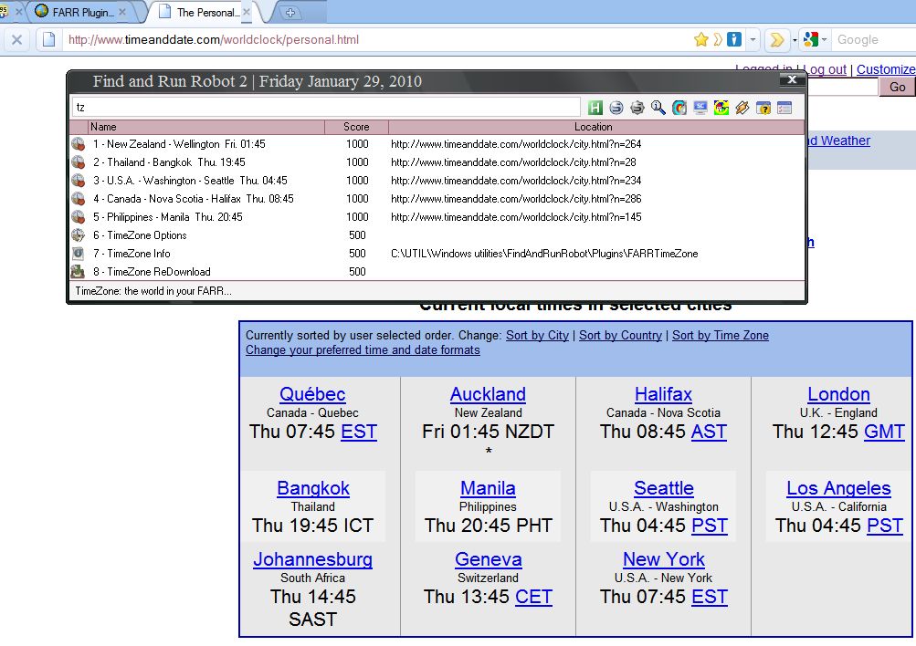

@Perry Mowbray: Thanks. I did promise to report back. TZ seems to be working correctly on the main timezones I am interested in (see screenshot below). As you can see from the The Personal World Clock page (timeanddate.com), I am interested in checking up to 11 time zones, so a max of 5 in TZ is OK but not ideal (for my needs).
Thanks for a great plugin, and thanks for fixing it so swiftly.

@Perry Mowbray: Wow! Many thanks!    :Thmbsup:
Now I can have all 11 time zones displayed. I haven't needed more than that in a while.
Much better using TZ - zero tediousness. Otherwise I would have to go to timeanddate.com, then login BEFORE I can select and view my personal clock.
