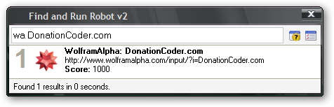

An an aside: How about someone make us a farr alias to search wolfram alpha?
as requested by mouser. i realize that their service is still in alpha stage. so this is a good time as any to try out. :)
thanks to [user]hamradio[/user] for the icon.
edit1: fixed the encoding bug, thanks to oioisaveloy.

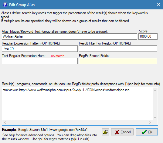

Note, if you want the result from wolfram alpha to display directly in your farr window, and not open your browser to show it, you can easily do that by changing the alias result from:
Code
WolframAlpha: $$1 | http://www.wolframalpha.com/input/?i=$$u1 /ICON=icons\wolframalpha.ico
to:
Code
WolframAlpha: $$1 | htmlviewurl http://www.wolframalpha.com/input/?i=$$u1 /ICON=icons\wolframalpha.ico

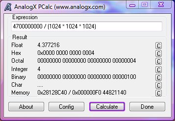

For calculations you can type in using C syntax, I've been using this little utility for years:
http://analogx.com/contents/download/Programming/pcalc/Freeware.htm
The result is shown simultaneously in Float Hex Octal Integer and Binary.  To copy the one you want to the clipboard there's a little 'C' button to the right of it.  Also you can use variables.
Just thought many people may not be aware of it. :)

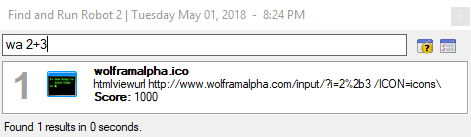

Alias:
Code

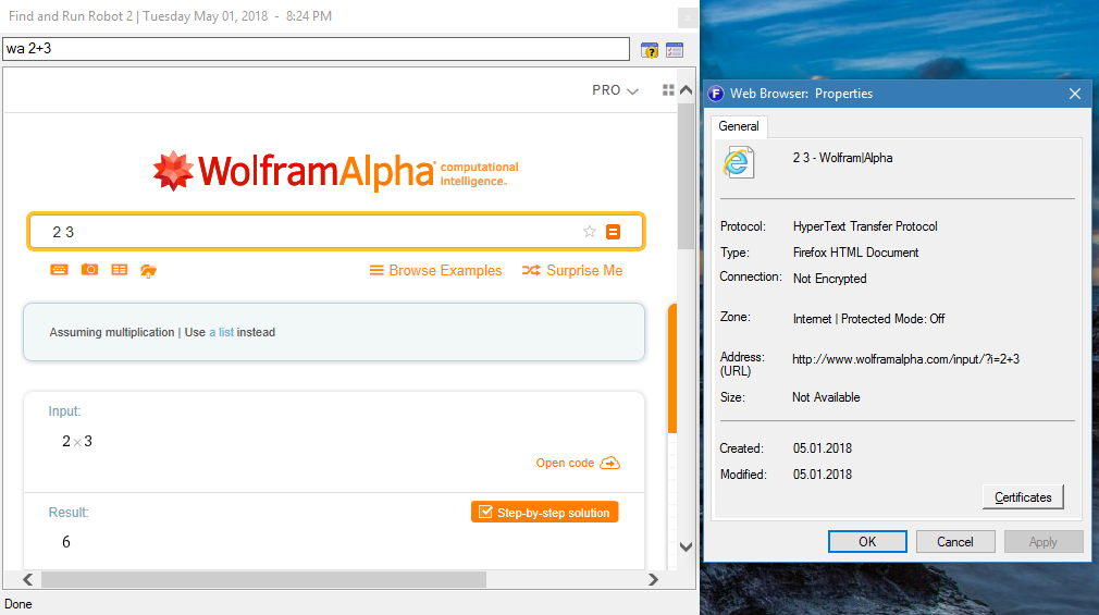

Input: "wa 2+3"
Target path:
Code
htmlviewurl http://www.wolframalpha.com/input/?i=2%2b3
I press Enter, got embed browser, right click, Properties, Address: http://www.wolframalpha.com/input/?i=2+3
So, URL encoding is somehow lost if using embed browser.
