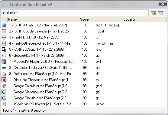

you might try this, restart farr -- see if farrSubScript is in list when you type: aplugins

No, "aplugins" doesn't show it.

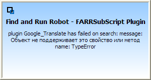

« Reply #34 on: August 13, 2009, 08:43 AM »
Greetings!
Recently I've encountered strange problem with GoogleTranslate
as I type 'gt en' and then press 'space' I get Google_Translate error.
(see attached)
I'm running version FARR 2.75.1.
plugin configuration is provided below
please advise.

    • Superboy Coder
Re: CZB pack
« Reply #46 on: October 03, 2009, 09:43 AM »
if you find any other bugs, or have any ideas let me know. I have some time for CZB coding now
If you have some time, I get the same Google Translate error as Anaderi mentioned above: http://www.donationcoder.com/forum/index.php?topic=17153.msg174212#msg174212

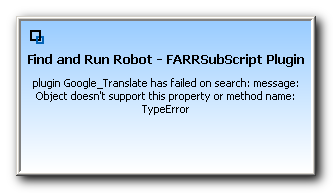

    • Superboy Coder
Re: CZB pack
« Reply #48 on: October 03, 2009, 12:40 PM »
Could you please translate what it says?
My apologies.  I forgot that his was in Russian.  Here's what mine looks like:
czb
  • Posts: 336
Re: CZB pack
« Reply #49 on: October 03, 2009, 03:25 PM »
Thanks. It is however difficult to track the bug as it does not happen to me. So could you please give me more information?
Does it happen only when you type "gt en"? or any other language? Please be precise even with spaces etc, so I know when exactly this happen.
Do you use fsubscript downloaded from this thread or any other?
Does the plugin work even with the message, i.e. can you use the google translater in CZB?
Is there anything else which might help me? :-[
Thanks for the information
