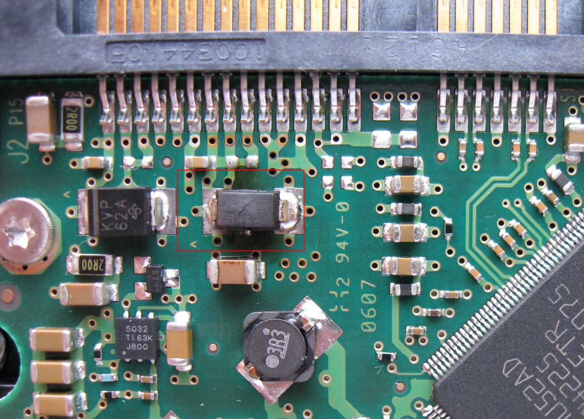

When I came back from my holidays, I plugged in my external drive. It briefly lit up, then stopped. I thought it was the enclosure, so I bought a SATA/IDE to USB adapter, and... It's dead. Yup. Nothing happens.
So it really seems like something burned in the hardrive external circuits... It smells, well, funny.
Now what? Should I try to bring it back to the store for "recovery"? It's only a backup drive, but I fear there might be something important on it that I forgot about and in a year I'll go : ooooooh noooooo!!!!! It'd be very very surprising though as I'm pretty well organized. It also might be very expensive to recover the data...
I could always keep it in a drawer, just in case...
Anybody with similar experience?

Actually, it might be even simpler than that.
I've had faults where it's just the protection diode has either shorted or gone open and it's just a matter of removing it or bypassing it.
Given that there are indications it's a short, isolating the protection diode might bring it to life long enough to transfer any data off of it.
Any chance of a high-res pic of the HDD pcb?
Who knows, maybe one of us has an identical HDD lying around we can send you the pcb off of.

Before doing anything, I will eliminate all variables. There's a short, that's for sure, but where... I followed 4wd's suggestion, and I believe there's something weird on the hard drive... What do you think?

if you trace the connection from the circled piece back to the big black connector on top you will see that some of these tracks (at the line of holes) have directed a lot of current to the component that is burnt to a crisp. Those holes are discolored (there is a group of three and next to the group is another one)..
This isn't a good thing, because these holes usually mean that the board has more than one layer of circuitry. So it will be hard to tell if and which other component(s) have been damaged as well.
Buying replacement(s) for the damaged component(s) will not be your biggest problem (price wise). However, the labor from the technician is, given the replacement value of a SATA harddisk.

Thanks for your diagnosis, Shades. Now I wonder:what did that...  a faulty enclosure ? the Sata-USB adapter ??? How can I prevent further damage to any other equipment that I'll have to buy/replace ?

You're so lucky, you have visual damage!
Even though it's unlikely that that little smd there is the only damaged part, it's worth spending the $1 on replacing the smd part. If it works you just fixed your hard drive for $1 and 5 minutes of soldering in a new smd part :)
If you don't know how, here's a video tutorial ;)

I could follow 4wd's suggestion and bypass the diode... Is the diode what I "circled" in the picture?
First you need to ascertain whether the component is in fact a diode.
Do this by removing the component, any soldering iron with about a 2-3mm spade bit will do.
Then grab your multimeter, set it to resistance scale, put one probe on the (ex)diode pad on the right then check for a short to some of the pins on the SATA power connector.  The pad on the left already goes to what is +5V on the SATA power connector, (SATA power), the pad on the right should go to GND.
If you get a short from the right pad to some of the power connector pins that correspond to GND then it's 99.9% probable it was a protection diode, (it's there to protect against the power being reversed).
Check once more to make sure there is no short between the left and right diode pad.
You should be able to plug the drive into a PSU and retrieve data off of it - I recommend you plug it into a spare connector of a real ATX PSU.  They are far better than the cheap adapters supplied with external cases.
There's no problem running the drive like this, my mate has run one this way for a couple of years.
As above, that diode is only there to sacrifice itself if you happen to reverse connect the power.
BTW, which connector was used to supply power when it fried (SATA or 4pin molex) ?

...As above, that diode is only there to sacrifice itself if you happen to reverse connect the power...
That may be true, (I used to do that all the time with stuff I built) but it's not all that diodes do. They also rectify AC voltage and introduce a 0.6V voltage drop (unless it's a zener) and your electronics downstream can sometimes depend on that. I would NEVER bypass a diode, unless I knew exactly what it was there for and could make a solid call that it didn't matter.
If you really want to get your hands dirty and hack this thing, check your adapter first and if it's alright, try soldering in a replacement diode. It's got a high chance of not working, it'll probably involve a magnifying glass and a steady hand, but the experience may well be worth it. I bet you got a spare diode around somewhere, maybe even cannibalize one from a really dead drive.
8)

Yes. If the adapter gets hot with nothing plugged into it, it is definitely toasted. If not, get a voltmeter and test that it's pumping the juice it should.
Switchmode PSUs really require a load in order to regulate correctly - therefore you'll need to plug it into a HDD before you can accurately measure the voltage.
We are talking about a HDD.
A normal HDD doesn't run on AC, (and one diode is not sufficient to fully rectify it anyway), and a HDD doesn't need a 0.6V voltage drop, which is only relevant for generic silicon diodes - it could be from approx. 0.2-0.7V depending on diode type, (discounting zener diodes).
On a HDD, the diodes connected to the power connector are only there to protect against reverse biased power - it is assumed you are using a fully-functioning, fully-regulated PSU with a correctly wired plug.
Just make sure the cathode, (the end of the diode with the band), is connected to the +5V rail and the other end is connected to GND.
But personally, I wouldn't bother replacing the diode.  Remove it, power it up on a real ATX PSU, get your data off and then toss it if you don't want to live with it like that.
