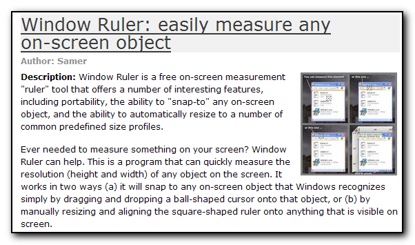

incidentally, freewaregenius did a write-up today about a program called Window Ruler.
• http://www.freewaregenius.com/2008/08/29/window-ruler-easily-measure-any-on-screen-object/

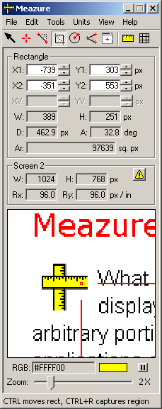

You could achieve that with a FastStone Capture (and probably with other similar tools) but if you insist on a seperate ruler tool... check out Meazure.
A utility for measuring, magnifying and capturing arbitrary portions of the screen.

thanks for the suggestions. i have actually tried all of these. i have tried dozens of these apps. but none work well for me, which is why i posted here.
Renegade's wouldn't even run. Window Ruler measures in two axes only. not very useful at all. and this last one, well it's big and it uses an installer so it doesn't seem like the small and portable app i am trying to find...
