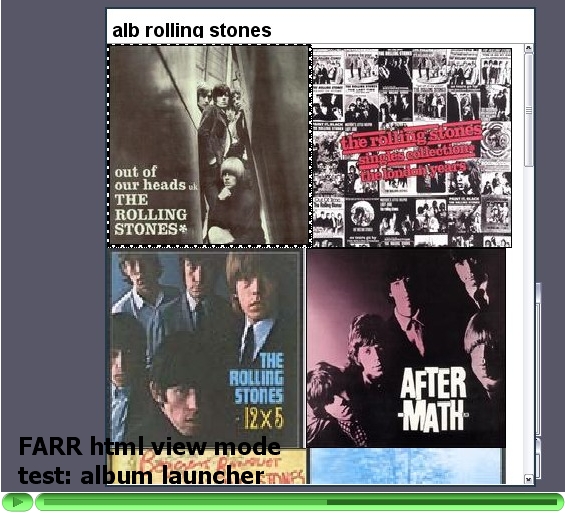

I updated my FARR html view mode test project: an album launcher. Here's a glimpse in the form of a short flash screencast:
http://nod5.dcmembers.com/farr_album_test.htm
I think it could be really neat when search as you type searching works! (still needed: a way to force the cursor back to the FARR inputbox).
Though I still think a native, non-html based way to display search matches as a list of images would be more powerful. Then we could select multiple match images (representing folders) and drag and drop them to some external application for example, right click them to do context menu operations on them, and so on. And that would bypass the index that my test above requires.
« Last Edit: July 02, 2008, 09:45 PM by Nod5 »
