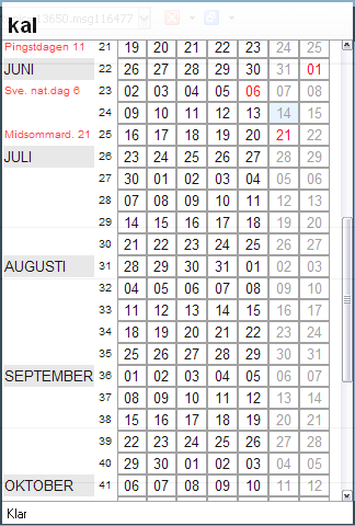

« Reply #14 on: June 13, 2008, 11:18 PM »
I just played some more with the new Html View Mode. :) I made a local .html file containing an ultracompact version of the Compact Calendar (  http://davidseah.com/page/compact-calendar ) and added some javascript to make it highlight the current date (= cell with light blue background in screencap) and scroll to the current week on launch. Needs some more work but so far it offers very quick date and week number lookup. Screencap (the red stuff in swedish are names of national holidays):
With the farr:// functionality I think dynamically adding tasks to such a html calendar (or any other local html for that matter...) could be possible roughly like this: For each table cell, add a farr:// link that runs some command with the cell id as a parameter. That command (tied to an autohotkey script or some plugin) edits the basic html file by changing the contents of the cell with the matching id and then refreshes the the displayed html. Not a real replacement for google calendar or other full features calendars of course, but it could still be useful for some things.

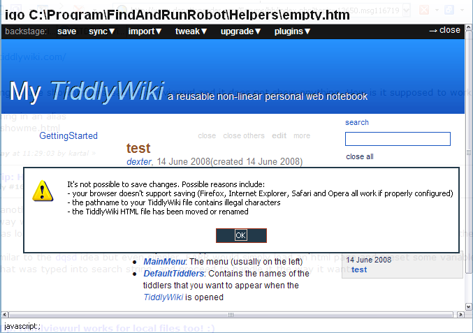

The basic tiddlywiki.com runs in FARR but I can't save:
Edit: but I get the same error in my regular browser so FARR isn't the problem. It's pretty obvious that I don't know much about tiddlywiki ;D
« Last Edit: June 13, 2008, 11:46 PM by Nod5 »
actually there is a farr-related problem here, im trying to fix it now.  believe it or not it's related to skin system.

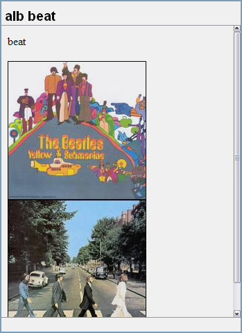

« Reply #23 on: June 14, 2008, 09:33 AM »
I just tested and it indeed works!
I made an alias "alb" that passes the search string to a the file "album.html" as a parameter. So doing "alb beatl" passes "beatl". Album.html loops over a list of foldernames and displays an image if the foldername matches the passed string. Each displayed image links to a .m3u file that when run plays the tracks on the album.
So the plugin I requested here seems more and more doable: http://www.donationcoder.com/forum/index.php?topic=8071.msg116150#msg116150
A drawback with the current test is that you in advance must index the folders and make the .html. A script can do that if the folders are well structured but it is still not ideal. It's also not as easy select and run a displayed match as in FARR's default mode. It would definitely be better if FARR's default mode could show a list of linked images like that. I think such a feature could be useful for other stuff too, like displaying thumbnails when searching for images. Or searching anything else for which a thumbnail can be useful really.
Here's "album.html" (to be placed in helpers folder):

Here's an updated version of my test file "album.html" that now also can handle two search phrases (both must match) separated by a space:

I tried it with a much larger number of folders and it works fine. Promising!
