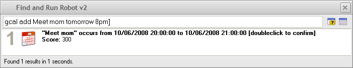

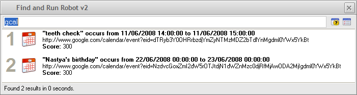

This plugin serves in two modes:
1) See your upcoming events up and directly go to them. Defauly keyword: gcal
2) Use the QuickAdd feature of Google Calendar to quickly add events. Before actually creating an event, you are given a preview of the date. Defauly keyword: gcal add

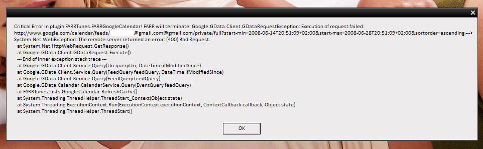

I tried installing it and restarting FARR. FARR crashed with the following error window.
[attachthumb=#1]

I also installed the file you linked to and gcalc crashes farr for me as well. When restarted, farr crashes again with the attached error.
Put the attached file (unzip contents) in the directory and tell me if that helps. If it does, I'll put it to the zip.
Your case is kinda strange. Can you try to go the URL that is displayed in your messagebox? What does it say? It can also be an issue with your credentials but not sure.

Hmm, I might have used username@gmail.com as username, instead of simply username (my screenshot says 'username@gmail.com@gmail.com' (username is blanked out)). Anyway, I also put your attached file in the plugins\FARRGoogleCalendar folder and now it works, so I guess that .dll file is required. Please include it as part of the plugin :)
icekin
  • Posts: 264
Re: New C# FARR Plugin: FARRGoogleCalendar
« Reply #8 on: June 15, 2008, 04:50 AM »
Thank you, it works now with the extra dll file that you attached later.
