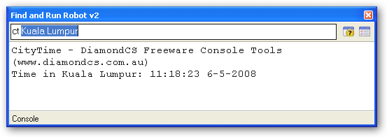

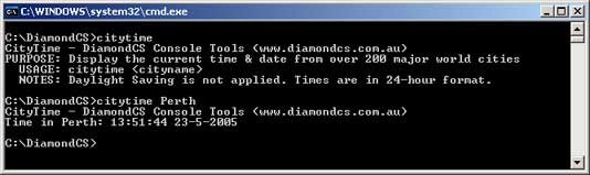

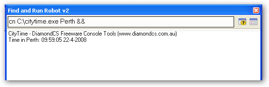

great work, czechboy! this works quite well. i'm testing this with a tool called CityTime and here is the output. :Thmbsup: btw, the note about the "&&" is an important clue. next, i'll try to make this work with an alias.
Before

after some tinkering, i've managed to get this working via alias and it get very interesting now as all cli tools that "displays info and exit" can now be routed this way in a nice Farr memo window. check out the screenshot and thanks again czechboy! 8)
as advised by mouser, i've re-packed czechboy's Console plugin with the citytime files and (exe and alias) so that you only have to unzip into Farr's "Plugins" folder to get it working. btw, for those not wanting download the whole thing, this is the code that triggers the plugin:
Code
1000>>>citytime>->ct $$1| dosearch cn "%FARRDIR%\Plugins\Console\Citytime\citytime.exe" $$1 &&>+>^ct (.*)
note: CityTime is available here and distribution is subjected to the following terms.
edit: duh! forgot to attach the file. but mouser had kindly zipped everything nicely. see one post below. :-[

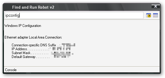

Lanux how do you use ipconfig?

jgpaiva,this is a custom alias. :) with czechboy's console plugin, create an alias with the following parameters:
regex: ^ipconfig (.*)
result(s): dosearch cn ipconfig &&
note: if this doesn't work, insert the full path to ipconfig (in the system32 folder on WinXP).

cn ipconfig &&
Re: Output to Farr's memo mode
« Reply #24 on: June 10, 2008, 09:48 AM »
ok, cool!
Apparently the problem was that it wasn't launching without the full path (Vista64 here, probably related)
