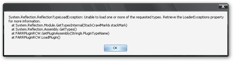

    • The problem with "FARR won't close after program launch" as described here: http://www.donationcoder.com/forum/index.php?topic=12210.0
    • The error of "Unable to retreieve types" as described in the message-box picture below.
    • Now whenever there is an exception or an error you should see WHICH plugin was causing it.
    Make sure you update ALL 3 plugins (GCUpdater should help you out here). Besides that anyone that used SDK to create a plugin should get latest version and recompile (specifically, FARRGoogleSuggest).

  • If you don't see the C# plugin in the FARR plugin list after the installation then download the following update from Microsoft.
  • If you get the following messagebox:
            System.Exception: Unable to load the plugin C# assembly
            at FARRPluginRCW.LoadPlugin()
    It is probably because you got an old version of FARRAltTab. It is suggested to DELETE the folder of FARRAltTab and download the latest one.
  • Some people get the following error using some of plugins, it can be sometimes resolved by getting the latest version. This issue should be RESOLVED if it isn't, let me know: [attach]

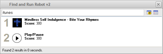

In the while, here's something little from a future add-in I am developing:
