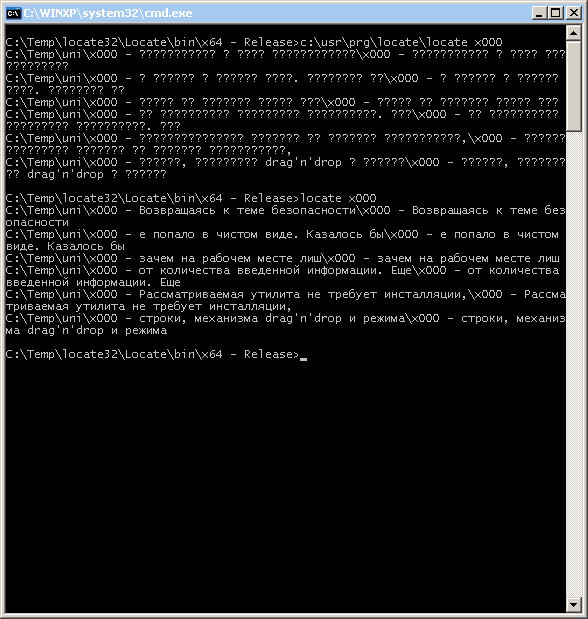

Ok, it seems that unicode characters do not work even in console. It worked when I tested before, but probable
used copepage was valid for those charactes (those was cyrillic or chinese alphapets, now I tested random characters).
So what all I should do to get it work like you want? Atm locate.exe uses wprintf
Hm, it did work for my test, but all I used was some russian text. I did have to choose a non-raster font for the console, though. My codepage is 850, I doubt cyrillic characters are valid in that codepage?
I guess we should take a look at the CRT implementation of wprinf (source comes with visual studio) and see how they handle it... but it breaks down to using WriteConsoleW for consoles, and WriteFile (possibly with wide->multibyte translation) for redirected stdout. If VS CRT doesn't do it this way, it means writing your own little printf. But since it's only really necessary for printing out the file paths, you can do without formatting specifiers etc.

It's not necessary to use wsprintf, until it's something which works.
You can try to fix it if you wish. If you haven't noticed, new address for the repository is http://svn.locate32.net/locate32. The repository can be read by anyone and your old password should work for writing.
Yeah, works, just checked out source from repo.

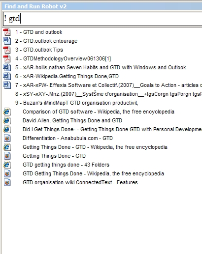

I mentioned some problems with diacritics and farr in the past (and I think it's been added to the official bug list):
http://www.donationcoder.com/forum/index.php?topic=10505.msg82218#msg82218

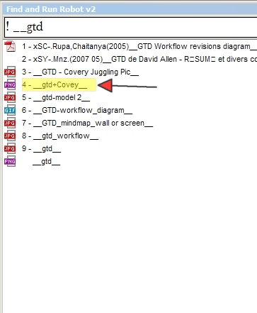

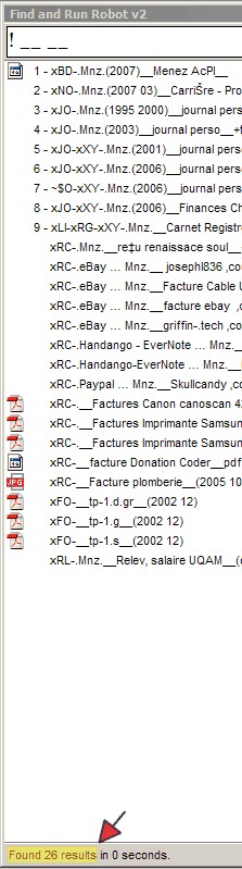

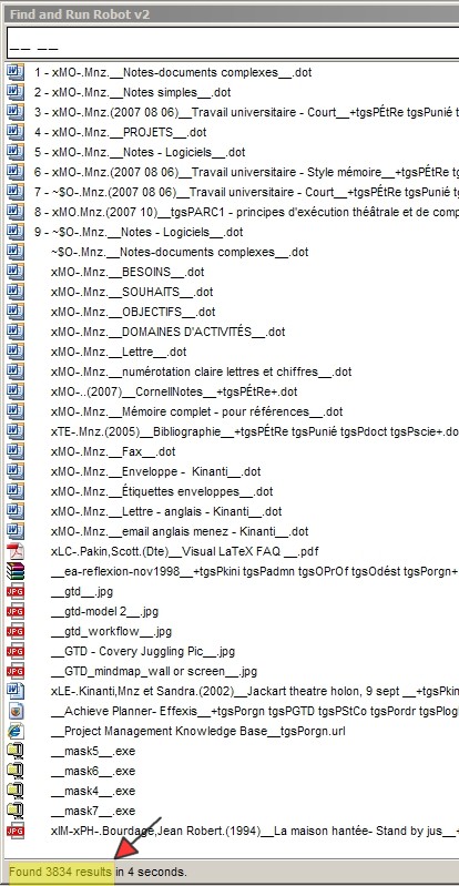

concerning the locate32 plugin, I'm having other problems, like trying to find filenames when they include characters like _ +
Here are some screenshots (the ! in the farr entry field is just my locate 32 trigger... faster than to write "loc").
I was looking for a gtd diagram. So i typed : ! gtd
And this what I got.
Glenn Gould

I played a little with writing results to a file and I finally forced locate to write in full Unicode:) But I'm rather inexperienced programmer and I used some dirty tricks to achieve that.

I'm soo lame :/ (or maybe Windows is?) In order to write wide characters correctly file need to be opened in binary mode. Then fwprintf works perfectly. No dirty hacks are needed.

BTW, anybody can help me with the issue mentioned in reply 82 (http://www.donationcoder.com/forum/index.php?topic=10501.msg93405#msg93405)

f0dder:
OK, so everything I know at the moment:
1. Console in Windows XP can produce full Unicode output but only for displaying. Piping and redirecting is unsupported so it's useless for us.
2. Standard printing functions like wprintf (used in locate.exe) uses built-in WideCharToMultibyte conversion (to DOS codepage in my case), so polish letters have wrong hexcodes in normal windows.
3. I'm able to write raw Unicode to console (swprintf+WriteFile, without widechar->codepage conversion) - when displaying it look like there are spaces between all letters, but after redirecting to a file it works like a charm (even without BOM :) ).
So everything we need now is widechar implementation of Locate plug-in. I don't have Delphi so I can't play with that :( Anybody have seen Okke recently? Maybe you have enough time to make plug-in with integrated Locate :)

I think it's unresolvable at the moment. We have to wait for fixes or full Unicode version of this plug-in.

So you think that characters like "_" or "+" affect the search because of incomplete Unicode compatibility ?

f0dder:
So locate.exe could be changed to use WriteConsole (if not redirected) and add e.g. '-w' command line argument to use WriteFile and Unicode character set. Then plugin could use that.

jmj: I want to play around with it a bit, as soon as I get the thing fully building ;). Is the filename output done exclusively from the two callback functions?
losiek: things are a bit different than that :). WriteConsole can write unicode characters because internally there's two versions of it: *A and *W, one for ansi and one for wide/unicode. WriteFile doesn't have ansi/unicode versions, and simply writes to the target device. There's no way for the console device to know what format it receives from WriteFile, so it opts to only support MultiByte...
There shouldn't be any problem using raw WriteFile when you detect output has been redirected. Or well, THE problem is that you're not outputting a BOM marker, which will confuse e.g. notepad, and that some apps might not be prepared to handle unicode text. The best is probably to convert to UTF-8 when output is redirected...

ANSI output should probably be left as-is; I dunno if WriteConsole has any advantage over WriteFile except for being able to output unicode properly to the console. Sure, probably less conversion layers to go through than WriteFile, but I doubt it's anything measurable.

No, I don't think that yours bugs are caused directly by lack of Unicode support, but I think that they're related. It seems that your bug work very similar to my ' (accent) bug. Can you check Location column in "loc +" results? Are there two (or more) paths for one file?

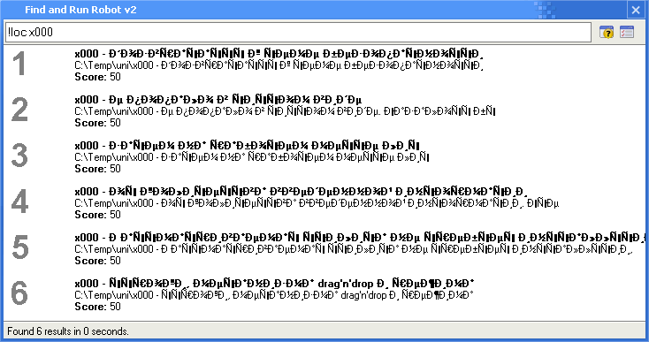

Okay, with a bunch of help from jmj, I managed to build locate... took a bit of effort, it's a semi-large and semi-complex project, also regarding library dependencies and such :)
Hacking up locate.exe to user either WriteConsoleW or WriteFile was easy, and I now have a version that does proper unicode output on console, and UTF-8 output when redirected, seems to work fine. The following screenshot shows what standard locate.exe outputs, and then what my quick hack outputs. Note that you need to set your console to use a non-raster font for this to work!
Note that there's no reason for me to release this new executable before Okke implements UTF-8 support, since you'll get pretty garbled output with the current plugin version :)
In case anyone is wondering what the text is, it's just snippets from a russian article I found about fSekrit, seemed fitting to use when I was testing unicode support in fSekrit, and it's the best unicode test snippet I have at all, since I know none of those characters are available in my own codepage :)

I guess I could reverse-engineer Okke's DLL and make it support the utf-8/unicode locate hack, I've already located the "spawn child process and grab output", which is referenced three times, but Delphi code is so naaaasty to deal with :)
EDIT: downloaded the FARR SDK, and realized the locate32 plugin source code is there, woo-hoo :). The plugin will need some updating (should be simple though), but it seems that FARR itself needs a bunch of updates to handle unicode. Working with mouser on the issue right now.
