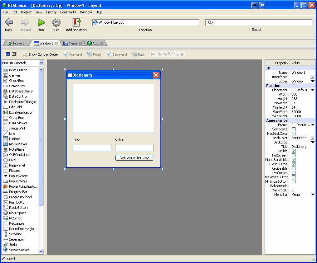

How about RealBasic - it even converts VB code for you. See http://www.realbasic.com/
It is regularly updated (and has an annual subscription model) and has a standard and professional mode. The professional mode allows access to facilities like SQL databases.
Worth a look and has the huge advantage that it is cross platform compatible (Windows, Linux and MacOS) so one code compiles to all platforms.
Here is a sample screen from the IDE:

« Reply #4 on: August 29, 2007, 11:53 PM »
I've looked at REALbasic before and from what I have read it doesn't appear to support the creation of activeX dlls.
