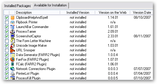

i'm sure this has been mentioned before but i couldn't find the thread. so here it is again.. what to do when DCU shows programs already installed as "not installed"? :)
as can be seen in the image below, i already have Farr (definitely), LBC, SC & CHS..
Re: Installed programs not recognized
« Reply #1 on: August 22, 2007, 02:20 AM »
that's troubling..
how did you launch the updater.. from the start menu or from another program?
can you remind me what OS it is?
i don't suppose you installed or ran the programs from one directory and then moved them?

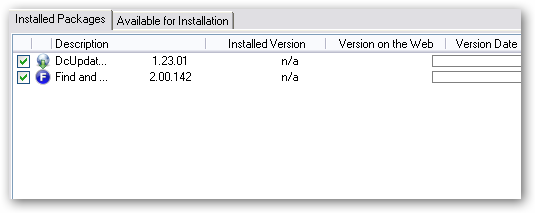

« Reply #6 on: August 23, 2007, 01:52 AM »
oh, darn! it doesn't work again.. :o shall i just downloading everything again via DCU?

thanks katkilla, will try your tip.. mouser, apparently this problem was introduced with version 1.23.01 because i am trying out on another PC and the previous version (1.20.03) did not show this behaviour.. :)
« Reply #14 on: August 30, 2007, 03:38 AM »
when i looked into the "C:\Documents and Settings\All Users\Application Data\DonationCoder\DcUpdater\RedirectFiles" folder, there was only "FindAndRunRobot.dcupdateredirect" file.. and when i launched DCU, it shows only Farr & DCU as installed..
can i manually create *.dcupdateredirect files and put them in the "RedirectFiles" folder?
