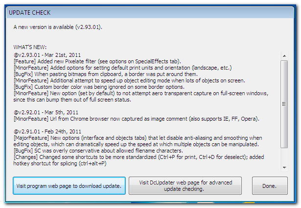

v1.08.01 - Mar 23, 2011
  • completely new dialog with buttons to open web pages shown when update detected; support for showing whats new
  • improved the -u unregister parameter; added icon to dcuhelper to improve message boxes (thanks Worstje)
The newest version has a pretty dramatic change in appearance, showing nice dialog and buttons instead of messagebox; and the biggest change is you can now show people whats new since their current version.  See sample.
I'm putting this out as a beta since there may be some rough edges, let me know.  Note: The new version will *not* work on windows 95/98.
Suggestions welcome -- look forward to any feedback if the new dcuhelper is helpful for you.

Any documentatiuon on how to expose the changelog?
In your server versioninfo.xml file you want to add a line specifying the name of the whatsnew/changelog file, like so:
Code
<?xml version="1.0"?>
<root>
	<Program_Version>2.95.01</Program_Version>
	<Program_Release_Month>6</Program_Release_Month>
	<Program_Release_Day>6</Program_Release_Day>
	<Program_Release_Year>2011</Program_Release_Year>
  <WhatsNewFile>whatsnew.txt</WhatsNewFile>
</root>
And then your whatsnew.txt file should be in same directory, with contents that look like this:
Code
@v2.95.01 - June 6, 2011
[BugFix] When capturing scans, the previous screencapture active window info could be kept in image comments.
[MinorFeature] Added Pixelate *outside* region special effect.
[Feature] Fixed bug in sorting by date and added new options to sort by either creation date or lastmodification date.
@v2.94.01 - April 8, 2011
[BugFix] Windows 7 (vista?) could give error on startup about inability to create a .redirect file for update checker.
@v2.93.01 - Mar 21st, 2011
[Feature] Added new Pixelate filter (see options on SpecialEffects tab).
(the list of changes can be ascending or descending, it doesnt matter; and only the version number after the @v is actually compared); the text lines after the @v# can be in any format you want.  it is simply grabbing the text between the @ lines corresponding to the new versions not installed by the user.
so if they have version 2.93.01 installed when this update file is checked, it will show the text from @2.95.01 through to above @2.93.01

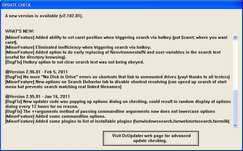

Don't know if this is the right thread - but....
I'm working on an XP machine that has FARR 2.99.02 installed and as far as i know that is the only DC program on the machine - certainly the only one that should be running.  it does what i need and i have no desire to upgrade it.
Today FARR has stopped working and instead confronted me with a pop-up as shown in the image.
  Note the lack of close button, minimise button, program identification or anything else. I didn't ask for it and I don't want it, the only way to get rid of it is to abort through the task-manager, and it's directing me to a website that i don't want to visit. Pretty much fits the definition of Malware.
What is going on here? I thought this site was populated by the good guys

@Flippertie: mouser just released a new Farr update and the pop-up seems to be a bug, an unfortunate side-effect. anyway, i'm sure mouser will fix this in no time.
