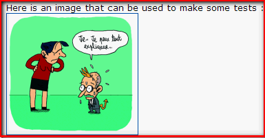

Here is an image that can be used to make some tests :
(edit : i changed the post so now there's a direct link to the image)
And here's the difference between real colors and false ones :
« Last Edit: August 12, 2007, 05:04 PM by ak_ »

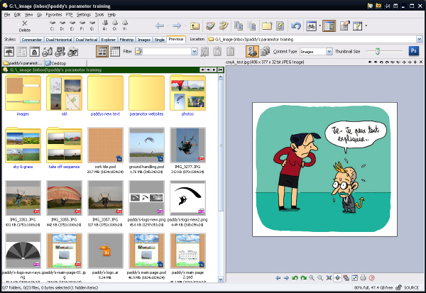

it looks like there isn't going to be a free program that works.
here's my directory opus doing it correctly. i wonder why it works on my system? I've got version 8.
« Last Edit: August 12, 2007, 07:54 AM by nudone »

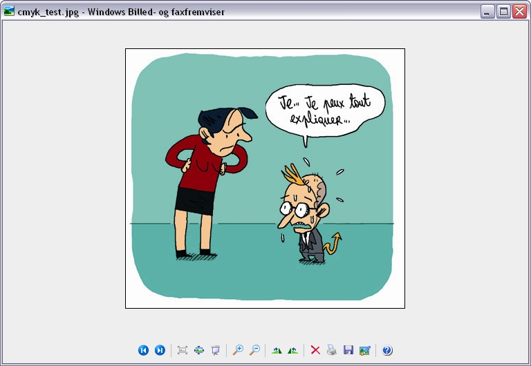

Re: Do you know a good image viewer with CMYK support ?
« Reply #13 on: August 12, 2007, 08:56 AM »

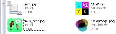

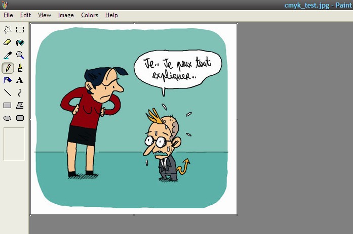

This (too) is making me curious: How can I test a picture that Windows cannot find? If I click the test picture, it will disappear, only leaving a little red cross ("picture is missing"). If I right-click it > "Save as...", Windows will say it cannot find any file and Windows Help will ask where to find "C:\WINDOWS\System32\mshtml.hlp".
And just looking at the test picture, it has the same colours as the "crappy colors" picture!
This is all confusing to me!

IE7 save target as function saves it as cmyk_test.jpg while Opera saves it as .png. Opening the image with paint shows the correct colors.
Grorgy
  • Posts: 821
« Reply #16 on: August 12, 2007, 12:12 PM »
now that interesting, i dowloaded it with ie7 as well and got the jpg instead of the png and the right colours show up in microsoft office picture manager and windows picture and fax viewer
« Reply #18 on: August 12, 2007, 12:58 PM »
Man, am I mystified!
Right-clicking the test picture and Saving Target As (JPG) it will display the thumb in Explorer with the "crabby colors", but opening it in Windows Picture and Fax Viewer will display the correct (I assume) colors!!:
I don't have any genuine CMYK images, so I don't know the answer to the original question, but it seems you should try Windows Picture and Fax Viewer"!

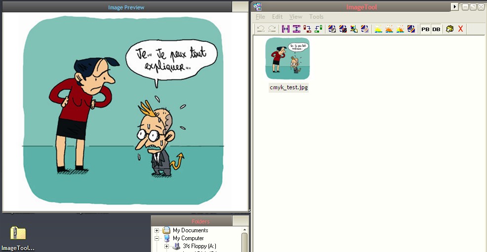

ImageTool can view it correctly.

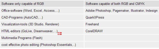

« Reply #24 on: December 20, 2007, 03:07 PM »
Found this on ColourAtlas:
When to use the RGB atlas and when the CMYK atlas?
Due to the fourth colour the CMYK atlas offers many more nuances, but its application only makes sense if the software and hardware being used support the CMYK colour model.
'Software only capable of RGB' and 'Software capable of both RGB and CMYK'
(click thumb):
In general only software that is customarily used in the preprint stage is CMYK capable. An overwhelming majority of programs only support RGB colours.
