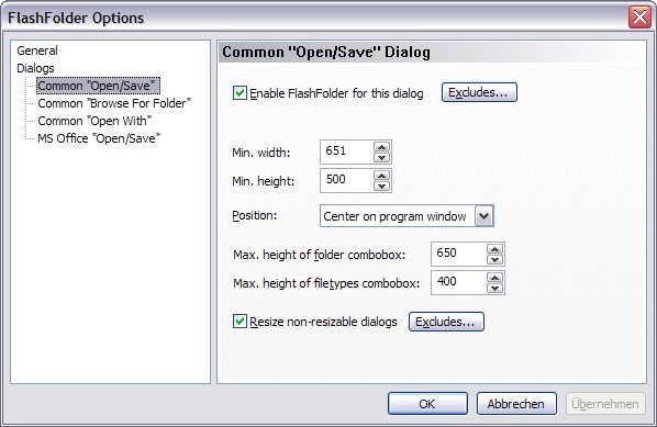

I'm using FlashFolder for similar purpose (http://www.zett42.de/flashfolder), it simply does what it's supposed to. I like its bar more than extra buttons on the dialogs.

yksyks, FlashFolder is quite a find! :Thmbsup: i also kinda like the bar it places above open/save dialogs.. :)
FlashFolder's toolbar
FlashFolder Options
