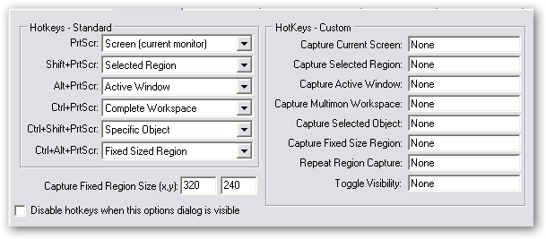

why not use ScreenshotCaptor where the hotkeys are configurable to your liking?
• http://www.donationcoder.com/Software/Mouser/screenshotcaptor/index.html
