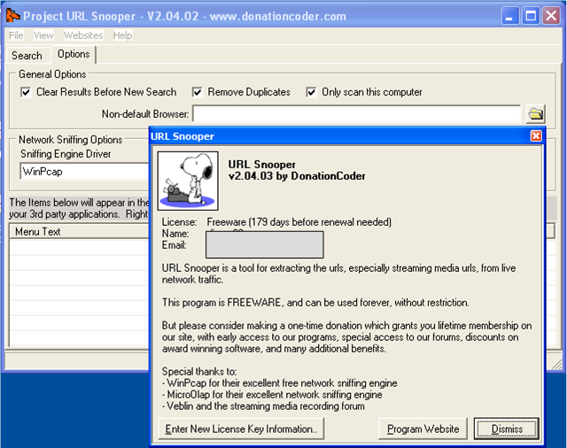

Downloaded URLSnooper 2 yesterday.  The download link showed version 2.04.01.  The about box tells me version 2.04.03.  And the window title bar shows 2.04.02.  ???

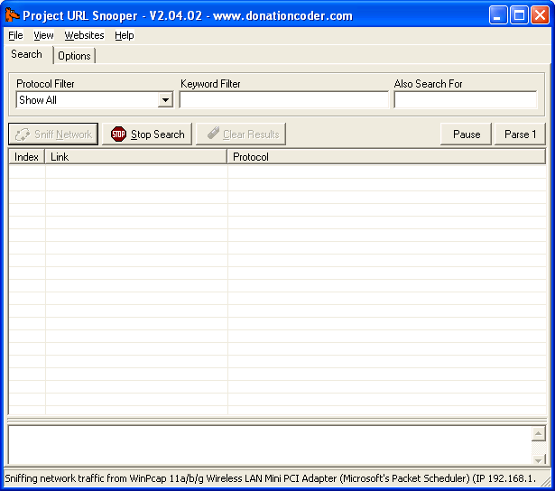

Nevertheless, the problem is I can't snoop any URLs at all.  After choosing the network adapter and start Sniff Network I can't even see URLSnooper counting packets.  Using Ethereal packet sniffing on the same network adapter works just fine.  Makes me guess the problem is not WinPcap or non supported hardware.  By the way, during the usage of URLSnooper, Ethereal was not running.  Tried with option "Only scan this computer" switched on and off.

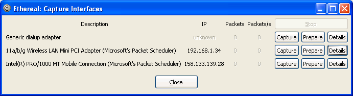

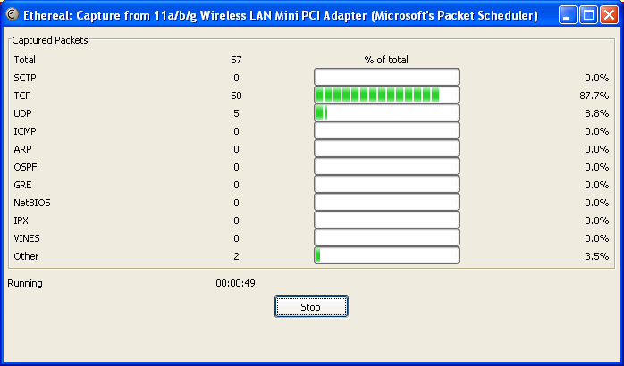

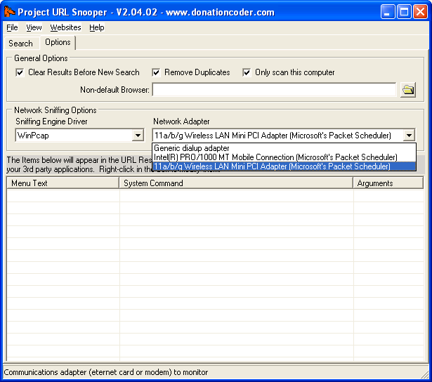

I'm using WinPcap 3.1.  I uninstalled and reinstalled WinPcap. I rebooted my PC 2 times.  I tried using URLSnooper right after rebooting the PC.  Nothing, not even one package was captured.  Closing URLSnooper and starting Ethereal.  Here there are the packets.  Closing Ethereal and retrying URLSnooper.  Same result, not even one URL gets captured.  (Where do I have to check the packet counter???)
By the way, I'm using the build-in wireless network card of my IBM Thinkpad T41 notebook.  To show my settings, I took some screenshots.  Hopefully you could see those in the attachment.
Since Ethereal works just fine, I still don't think the problem is WinPcap or my hardware.

i think i remember something about intel capturing not working in promiscuous mode, but i see you have url snooper set to only capture from your computer, which should bypass that.  but maybe there is something i'm doing wrong there.  i will take a look at ethereal and url snooper and see what i can figure out.
from what you're saying, url snooper must be doing something differently than ethereal, that we should be able to fix if you stick with me and we try some experiments.  i will try to have some tests to try this weekend and we can try to figure it out.

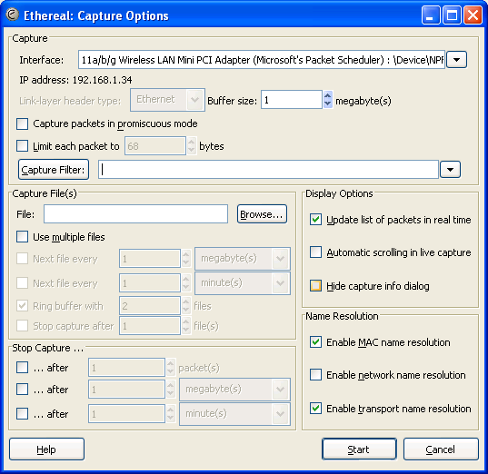

in your "Capture Options" screen in ethereal, if you check "promiscuous mode", does ethereal still work?

If "promiscuous mode" is checked, ehtereal doesn't work either.  It looks like you are on the right way.

yep, i'm guessing that i used an alternative way to restrict packets to the computer which is always basically in promiscuous mode, so your intel ethernet is not working - i should be able to fix this weekend.

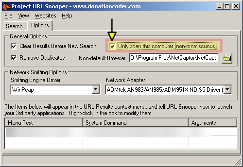

1) the method turning off promiscuous mode has been adjusted to better work around bugs preventing some lan adapaters (ibm) from sniffing unless promiscous mode is turned off in a specific fashion. If your adapter doesn't seem to sniff traffic make sure to try checking "only from this computer" option.
2) the only sniff from this computer option has been made default.
Please let me know if it works digger (make sure to check the box that says "only sniff this computer" in options)
note that you do not have to reinstall winpcap, and you can install this version on top of older version without uninstalling.

Version 2.04.04 works with "Scan only this computer" switched on.  Without this option switched on I still wasn't able to sniff anything.  I guess this behaviour is like expected.

yep, as i said this is a known problem with some (especially ibm) network adapters that can only scan in non-promiscuous mode.
in previous version of url snooper i was always leaving the adapter in promiscuous mode and using a different technique to restrict scanning to only the current ip.  now i officially switch the adapter between promiscuous and non-promiscuos mode, and i guess that was what was needed for your network adapter :)
glad to hear it works, i'll make it an official release tonight and i expect your bug report will end up helping quite a few people who had same problem as you :)
