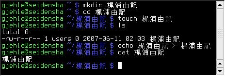

some guidelines:
yes i would avoid using periods except to separate a file extension, as you will confuse programs that treat anything
every windows program i used (except for some crappy 8+3 16bit stuff back in the days
was able to handle multiple periods just perfectly fine
/([^\.]+)$/ FTW
and while i'm a friend of the "strict US ascii", "no spaces", "all lower case" i have recently switched to unicode/utf8 for all filesystem related stuff
it's kinda nice to be able to browse folders like this without problems:
/([^\.]+)$/ FTW
Good to know.
Nice.
How does one switch to unicode/utf8 in windows? Through the control panel "Regional and Language Options"?  Please forgive my ignorance... :-[
