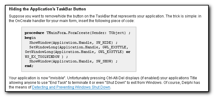

programmatically, it's possible as this page shows..
http://delphi.about.com/od/kbwinshell/a/big_brother1.htm
