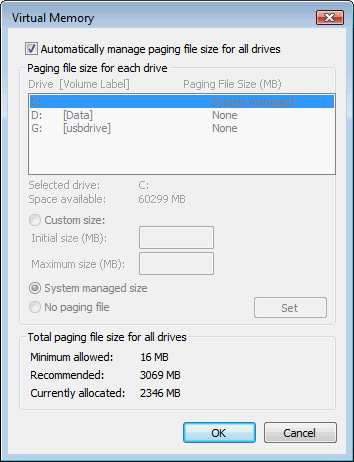

Assuming you're running XP:
System Properties --> Advanced --> Performance settings --> Advanced --> Change virtual memory
If I were in your place I would consider monitoring the memory usage with something like Process Explorer. I have a gig of RAM and have 10-20 apps running (with realtime virus scan enabled) at any given time and my RAM usage is generally at around 50%. You should not be facing this problem unless you have a really memory hungry/buggy app going gaga!  :)

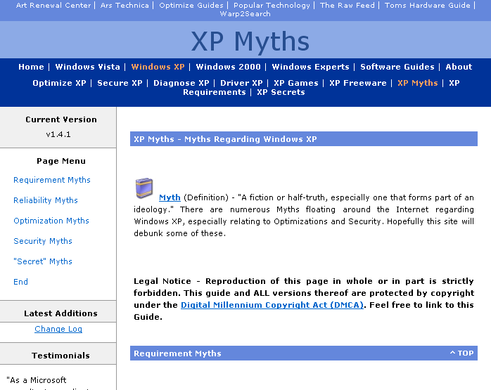

There are many tweaks on pagefile usage, however the people in the know agree that Windows does the best job if you just let the system manage it. It is actually swapping out dlls that it can still load in when needed but making room for your apps. Limiting the pagefile, fixing its size etc will just limit your performance not increase it. Running less apps, minimizing windows (so their memory will be written to pagefile) or buying more RAM / quicker Harddisk are really the only significant ways to improve performance.
A great site about performance myths on XP is Xp Myths. IT deals with  Clearing the Paging File, Disable the Paging File, Moving the Paging File and Paging File RAMdisk.

BTW, in vista the dialog has changed a little, it seems the OS is aware of multiple physical disks and can manage this effectively on its own (or not, whether or not grayed out options reflect the managed status or the disabled user options):
