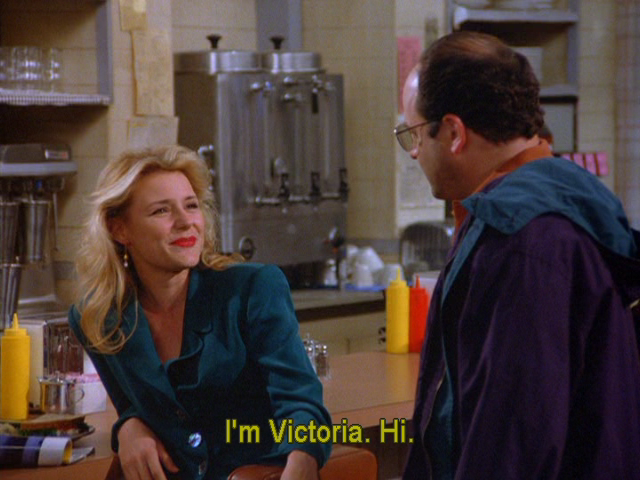

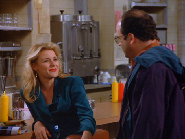

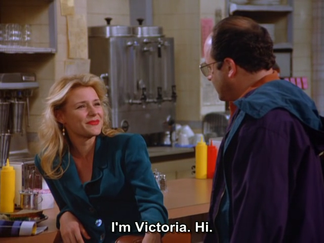

And the final results? VERY impressive if I say so myself.
Here's the original DVD. It's being resized to 640x480 by The KMPlayer, but that's it. I honestly don't think the quality is affected in the slightest.
Here's an Xvid-AVI that I made with DVD Rebuilder Pro. It looks just fine. I didn't spend too much time messing with the settings, but there weren't many either.
And the crowning jewel: The x264 MKV! No, I didn't mix-up the pictures, the final encoded file looks BETTER than the original DVD (in my opinion at least).
You might be wondering, what about the file sizes...
DVD: 876 MB
AVI: 299 MB (This only has 1 audio track and no subtitles) (Encode Time: ? ~15 minutes or so? I can't remember. ?)
MKV: 206 MB! Sweet! (Both audio tracks and 2 sets of subtitles) (Encode Time: 124 minutes, wow)
I'm quite proud of the results! Was it worth my time? That's debatable, but it does look good.
[edit]Oploaded screen caps that include some subtitles. God DVD subtitles are ugly![/edit]

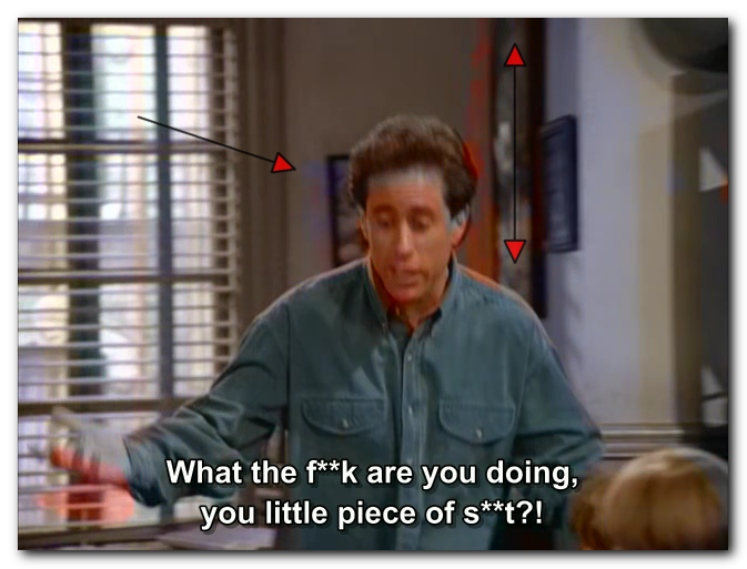

Like Dis
A=AVISource("F:\!TV - Seperated\Seinfeld\05\0519 + 0520 The Raincoats\0519 + 0520 The Raincoats.avi").Trim(0,61426)
B=AVCSource("F:\!TV - Seperated\Seinfeld\05\z-Compare\0519 + 0520 The Raincoats - 19.dga")
C=AVCSource("F:\!TV - Seperated\Seinfeld\05\z-Compare\0519 + 0520 The Raincoats - 3 Pass.dga")
StackVertical(ssim(A,B,"F:\!TV - Seperated\Seinfeld\05\z-Compare\0519 + 0520 The Raincoats - 19.csv","F:\!TV - Seperated\Seinfeld\05\z-Compare\0519 + 0520 The Raincoats - 19.txt",lumimask=0),ssim(A,C,"F:\!TV - Seperated\Seinfeld\05\z-Compare\0519 + 0520 The Raincoats - 3 pass.csv","F:\!TV - Seperated\Seinfeld\05\z-Compare\0519 + 0520 The Raincoats - 3 pass.txt",lumimask=0))

The main reason I'm going to keep that PAR is to maintain quality (no scaling until playback). But avoiding letterboxing is also a very good reason for PAR.
I haven't had to crop anything yet, but I think I'll probably crop the letterboxes out completely and resize it slightly so that each dimension is a multiple of 16.
