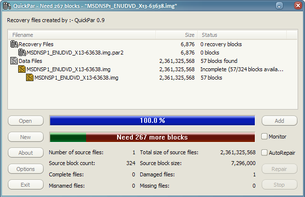

Ok, this is one of those things which s so bad it's funny, there was obviously something interfering with this download because it's nearly completely corrupted :D
[attach#]
justice
  • Solve issues simply.
  • Posts: 1,898
Re: Utility to get one good copy from three corupted ones?
« Reply #10 on: May 10, 2007, 09:51 PM »
I only uploaded 7 recovery blocks which was 49MB, looks like you best download it from scratch indeed, the patch / pars would be as big as the original.
