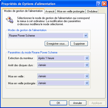

Wordzilla  : yes, I have, but nothing suspicious there :
.merle1.
