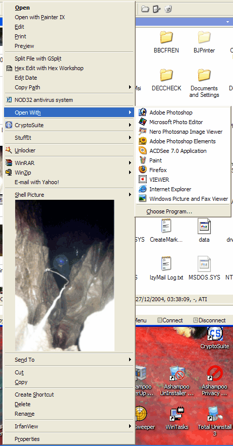

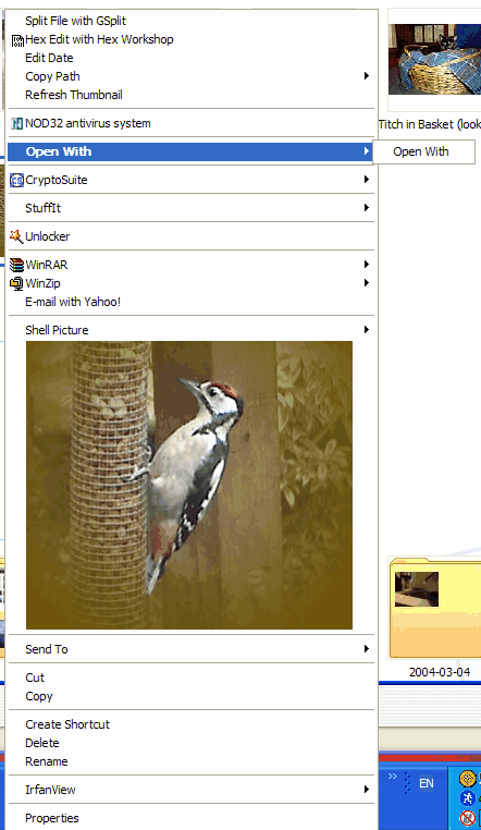

The really strange thing is that the context menu works correctly in Servant Salamander but not in Windows Explorer
Here are two images to compare:
The first one is from Windows Explorer - the second from Servant Salamander
Both have the Opne With ... submenu open
« Last Edit: September 05, 2005, 11:30 AM by CarolHaynes »

Sala use his own code (salopen.exe if checkt), it's diff from WinExplorer
Greetings, Stefan.

Thanks both of you.
I had completely forgotten about ShellEx (even though I have it installed).
It turned out to be two context handlers causing problems ...
IrfanView shell extension has long been installed on my system but now it causes the main context menu to lose its Open/Print etc. items from the top. The Open With ... menu is however left untouched.
But CryptoSuite was the big culprit - removing both Open/Print etc. and clearing the Open With Menu ....
Strangely these problems only applied to graphics files.
I presume there must be something more subtle going on with my system.
Could someone please confirm that the context menu work properly with Ghost Security Crypto Suite installed on a JPG file. (I am using windows XP Pro SP2) before I send a potential bug query to Jason  :-\

Re: File associations screwed - anyone help?
« Reply #15 on: September 06, 2005, 01:32 PM »
Hmmm ... went back to play with this and see if I can resolve the issue.
Disabled all context menu items in ShellEx and then re-enabled individually.
No probls with IrfanView Extension or Ghost Security CryptoSuite
- or anything else ...  :down:
What I did find though was that leaving ShellPicture disabled allowed all other context menus to function ... so
I either have Shell Picture or IrfanView + CryptoSuite but not all three.
Very strange but I have removed Shell Picture for the moment.
Interestingly I had a copy of ACD mPowerTools which I hadn't used in a long time (since most of its functions are provided by ACDSee). mPowerTools also provides ContextMenu thumbnail for graphics files and loads of other options, but when I installed this I again got the same problem.
I wonder if it is to do with the way graphics are added to the context menu ??
Any one got any other context menu addons that add graphics so that I can test this theory out?
