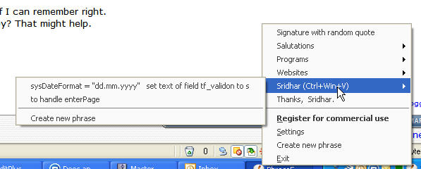

I added some phrases to a folder in PE and associated a hot key to bring up the items in this folder. The menu comes up when selecting any item and hitting return doesn't paste the phrase.
Screencast of how it's not working for me: http://www.sridhareena.com/addons/screencasts/PhraseExpress/Untitled.html
Any idea what's wrong? I would've posted on their official forum but for the spammy posts filled up there.

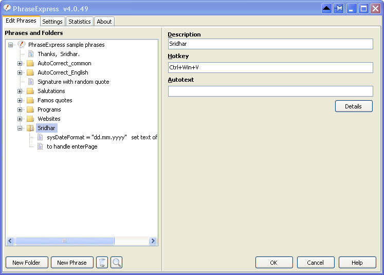

Do you have a screenshot of the screen where you have set the hotkey? That might help.

Here are the screenshots:

But on your problem, you should try and pinpoint where the problem lies:
Do any of the example phrases work? if not try creating a new rootnode (you have created all your phrases of the "sample" folder, which has its own settings which might conflict). If the standad phrases work then it's probably a setting that needs changed.
If nothing work you might have another program running with the same shortcut or another program that logs your keys. Hope that helps.

I found out the prob w/ PhraseExpress on this laptop. It's conflicting w/ XMPlay. Once I close XMPlay, it's all fine.

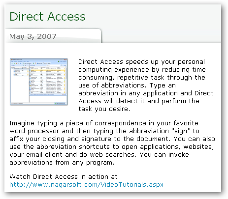

While we are on the topic of Auto Text Expanders, here's a commercial one for free (for about 22 more hours).

yes, Giveaway of the Day is a good site to be bookmarked.. :up: btw, Direct Access's author was at DC some time ago..
