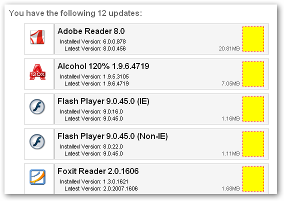

introducing filehippo's update checker... looks quite neat.
The Update Checker will scan your computer for installed software, check the versions and then send this information to filehippo.com to see if there are any newer releases. The results are then displayed in the browser for you to download.
here's the privacy policy:
The Update Checker will not send any personal information back to filehippo.com. The only information collected is a list of programs and their versions, along with the operating system details to help with processing. Additionally none of this is linked to your IP address and the logs are deleted after processing.
works quite well on my pc.. :)
