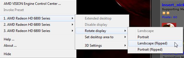

AMD also offer the option, as does Intel integrated gfx, (well it does on my old netbook).
AMD CCC tray icon right-click menu
Do you mean, it needs a second monitor for the feature to work?
No, he means that you can flip each monitor connected to the card individually - it's not all or nothing.
As per screenshot, each item marked AMD Radeon HD6800 Series is one output connected to a possible monitor, each has it's own setting irrespective of the others.
EDIT: Although, after having tried it, (and the attendant reversed mousing), it's actually 180deg rotation not flipping.
Yes, rotation is quite usual. Flipping (for use with mirror) is not.
