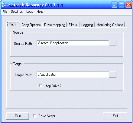

Remember to use a good copy utility (robocopy or such) that knows how to do copies with large buffers and overlapped I/O so the device drivers have the best chance of getting things optimized.
