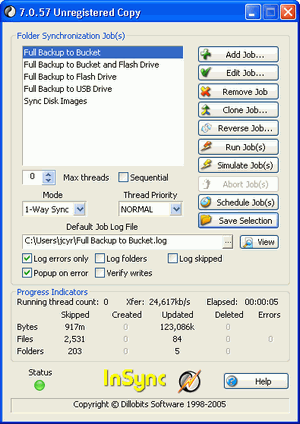

I have been using Dillobits InSync for my mirroring needs.  I found it much faster and accurate than synctoy or syncback.

Taichimaster, could you run a simple test comparing your favourite Dillobits InSync against SFFS? that'd be great.
