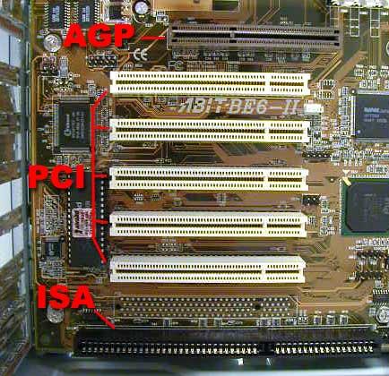

I guess they're PCI slots then.  I guess I could take a photo of my PC's innards and let some of you hardware-knowledgeable folks ID it for me ;)

Yeah, and if you are still using SD-RAM then you definitely don't have a PCI express slot.
Take a good look at this, it will show you exactly what you have and then you'll know what kind of card to go buy. Let me know before you install a new card though as it's best to backup and then remove all your old video drivers before installing the new hardware and drivers.

Yeah, I have pretty much that same layout.  I have a slot that looks just like the AGP shown in this picture.
I mistakenly said, earlier, that my PC has SDRAM.  I was thinking of my old Dell.  My current computer uses PC3200 DDR memory modules.
