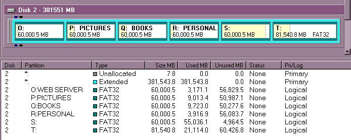

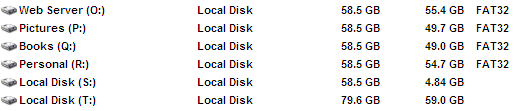

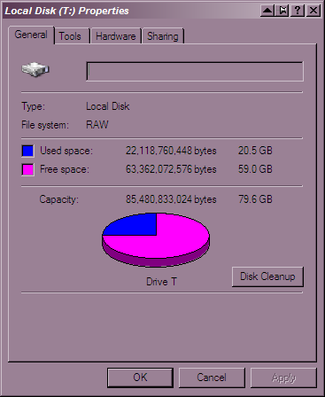

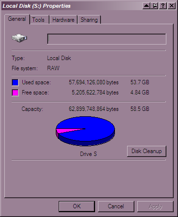

Well here is what I am looking at:
In Explorer:
Properties of S:
Properties of T:
Partition Magic:
(it didn't say it was FAT32 last time I checked it, but now it does)

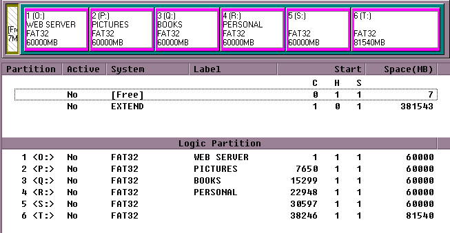

« Reply #7 on: January 28, 2007, 07:27 AM »
This is what PTD is showing:
Is there some sort of diagnostic tests in this? Because I didn't see anything other than a surface scan that this program can do.
And there was nothing that suggests that anything is wrong.
Re: Hard Drive File System Questions
« Reply #8 on: January 28, 2007, 12:15 PM »
When you start PTD it scans the drive to see if the Partition table is consistent. You can force it to do this using the Partitions > Check Properties.
If it reports the partition properties with no problems showing the fault must lie somewhere else. The trouble is programs like Partition Magic tend to use Windows utilities to do the formatting and verifying so if you can't sort it out via Windows Explorer you are likely to find PM won't be able to either.

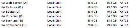

« Reply #9 on: January 28, 2007, 10:58 PM »
Problem is solved!
Now let me explain how I did it...
I was told by a friend that Partition Magic has problems if you create more than 4 partitions on a hard drive with it...it will screw up partitions #5+.
Solution:
  • Use Windows to destroy the last 2 partitions.
  • Use Windows to recreate them and format them NTFS, if that is the only option you have.
  • Use Partition Magic to convert the 2 partitions to FAT32, shrinking them to under 60 gigs if necessary, first. (expand them to desired size when finished)
  • Reboot.
This worked and everything is now correctly reported.
