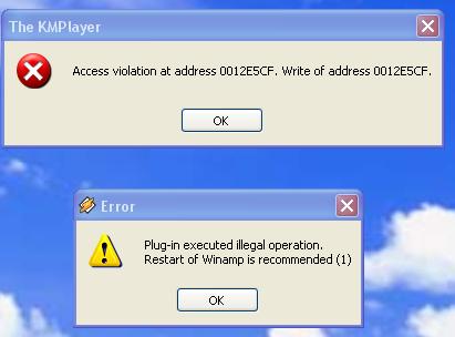

this new xp install was to be my masterpiece operating system. since its first boot up, i've been keeping a log of every install i make, every setting i change, every issue that occurs and how i fixed it. it was all going so well.
yesterday, the new xp install decided to start playing up - winamp creates errors when trying to run the visualizations and kmplayer complains when i click on a specific set of preferences. poser 6 also wouldn't work as it should. all these things worked perfectly well the day before.
no problem you might think. i've been keeping a log of what i've done to the machine, i can simply revert back by uninstalling and reinstalling, etc.
well, i've tried everything: reinstalling, deleting, using xp's system restore which didn't work at all, and the final kick in the teeth which has nearly pushed me over the edge of sanity - i used acronis true image to restore the entire partition.

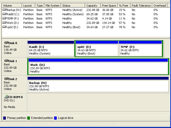

here is the drive layout to clarify things:
both operating systems are on the raid 0 disk 0. the dodgy drive(?) is drive 1 (work)

fortunately, the problem drive is not in the raid 0 setup - it's one of the samsung drives used for just storing files. the drive has had all data removed from it, formatted twice, using different formatting programs, most data restored and then several chkdsk scans run on it - some of which worked perfectly some caused the machine to reboot. currently the drive seems to be fine, i.e. it has not caused any reboots for about a week.

both operating systems are installed on the raptor drives which are in raid 0. all scans on these drives have always performed perfectly.
current scans on the bad(?) samsung drive report no faults. no SMART problems either. i still haven't run the manufacturers diagnostic util on the drive but it looks like i will have to - though i don't believe this can be the problem causing the programs i mentioned to behave strangely.
