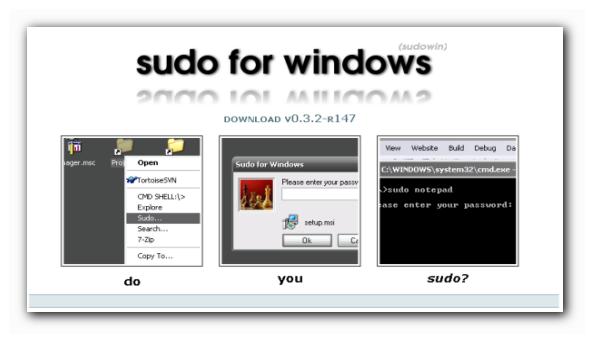

FTW-
Sudo for Windows (sudowin) allows authorized users to launch processes with elevated privileges using their own passphrase. Unlike the runas command, Sudo for Windows preserves the user’s profile and ownership of created objects.
from Google

« Reply #9 on: November 21, 2007, 10:17 AM »
Did anyone try sudowin in the end? Their documentation is excellent and this looks to be just the right balance between lock-down and liberty.
http://www.lostcreations.com/sudowin/about
http://www.lostcreations.com/sudowin/documentation
See also: http://sudown.sourceforge.net/index.php
