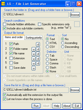

You might like LS - File List Generator (for Windows)
« Reply #9 on: January 07, 2007, 12:16 AM »
Nice find rjbull!
This tool collects the information about files and sub-folders under the specified folder or drive and generates the list in your preferred format.  You can individually specify your desired information types to include in the list. You can even customize the listing order and sorting priorities. The output format of the list can be chosen from txt, html, and csv (Excel's primitive file format).
This tool can collect the following information items: path, folder name, file name, extension, file size, save date. Then, the tool:
* Generates the list using only the items you select,
* Allows you to customize the listing order of the selected items,
* Sorts (rising/falling/no sort) multiple items while generating the list,
* Allows you to specify the file size unit from no units, bytes, KB, MB, GB,
* Allows you to specify the delimiter from space, tab, comma, slash, and no delimiter,
* Supports drag & drop operations when you specify the location of a folder,
* Includes an Abort button to stop the operation when a folder is too big or a machine is too slow.

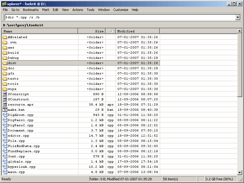

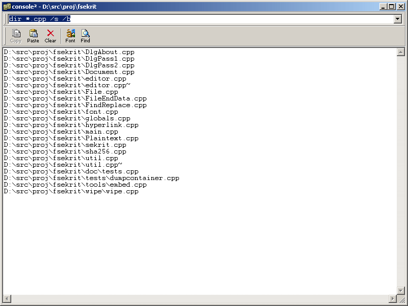

I really love xplorer^2 since it allows me to write shell commands in the location bar, that run in the context of the current folder. If I'm in [/b]d:\src\proj\fsekrit[/b], I type $dir *.cpp /s /b in the location bar, and up pops a window with the files. - and it's not even a console window, since xplorer^2 redirects input/output and handles it itself :)

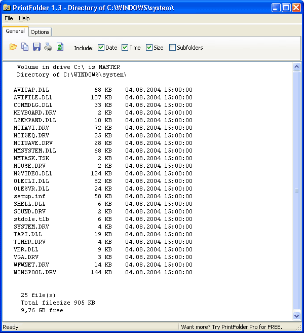

Printfolder
http://no-nonsense-software.com/freeware/

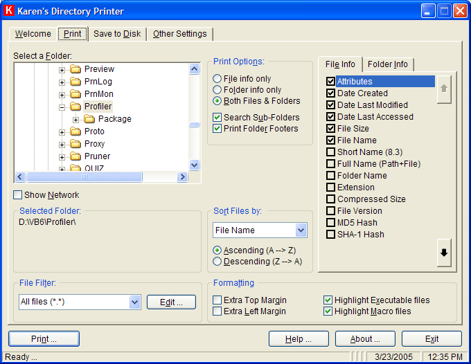

Karen's Directory Printer
http://www.karenware.com/powertools/ptdirprn.asp
These can both be gotten from a right-click, is this what you need?

I've been trying every different small app for this I run across, and so far Karen's app keeps impressing me more and more
