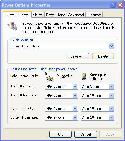

Re: IDEA: Replacement Power Options applet
« Reply #34 on: January 20, 2007, 11:59 AM »
Nope - changed it to 1 and it made no difference.
Here is my Power Options applet:
The battery options are because I have a USB UPS which WinXP recognises as a battery.
