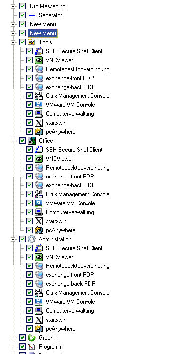

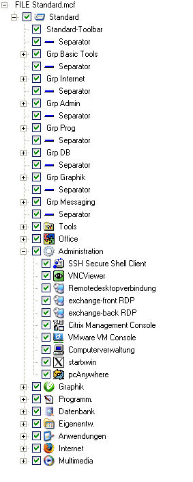

i added two snapshots
as you can see, after inserting two new nodes, the content of the third group is displayed in the first and second group too following the insertion point.

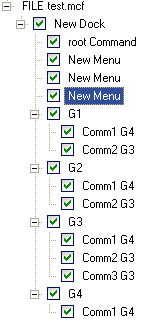

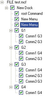

ok, i did some testing with this version: i created a new file, added some groups filled with some commands (see stage1). Then i added step by step three additional entrys above the existing groups (stage2 to stage4)
See yourself in the attached screenshots...
