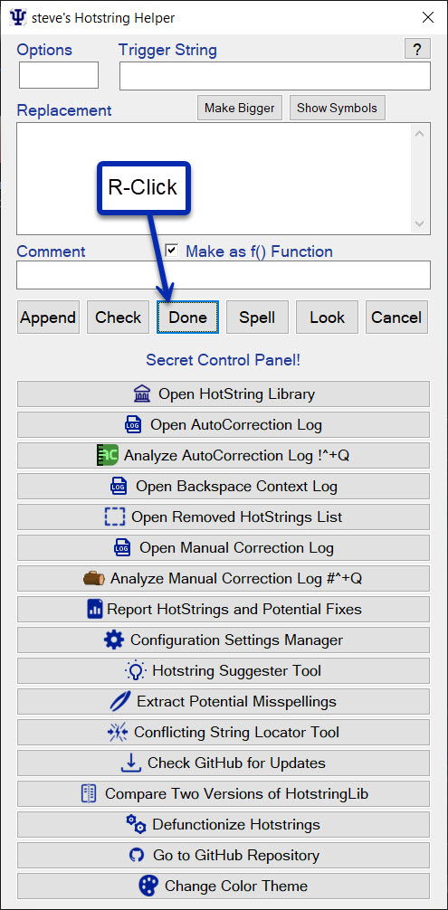

-The “Exam” pane is for fine-tuning AutoCorrect entries before saving them.  Right-click the Exam button for a list of buttons to related tools and files.

Screenshot
Image of HotstringHelper2, showing Control Pane.
