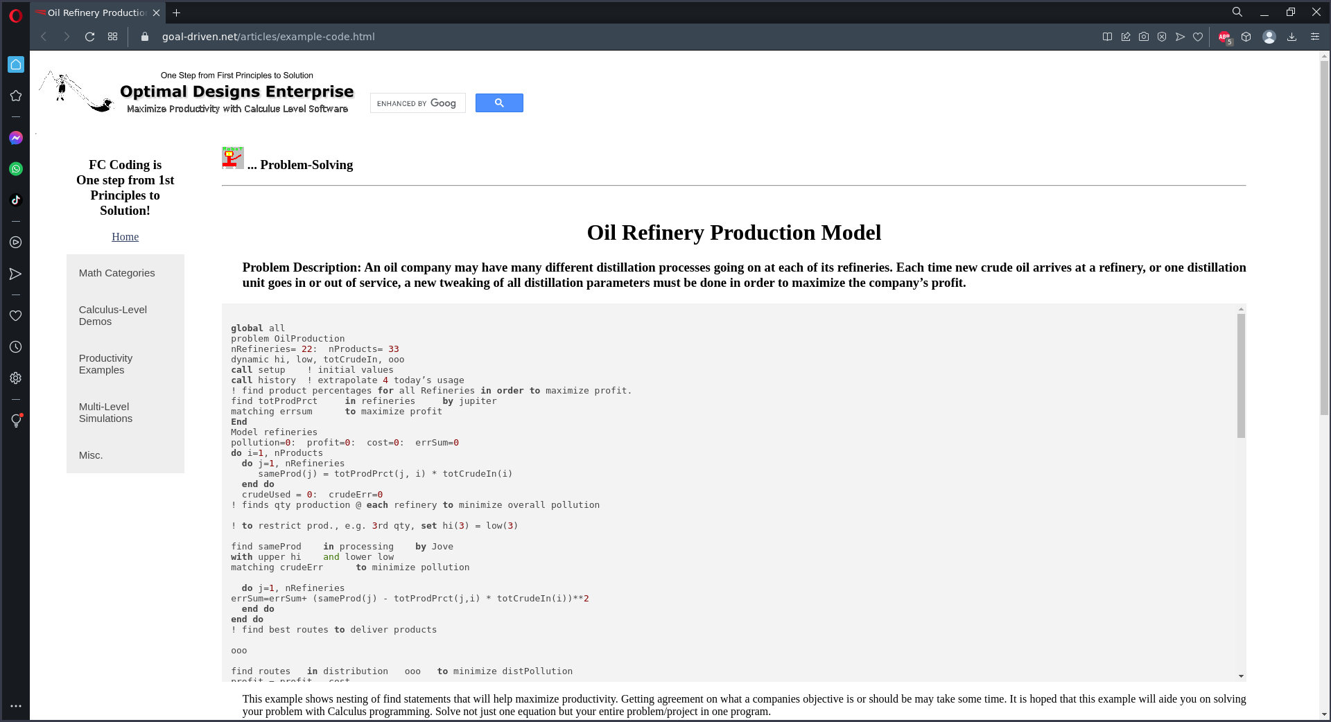

Is this your requirement?  :)
If so, just add the max-height style to the current code tag in your HTML page:
Code
<pre><code style="max-height:40em;">

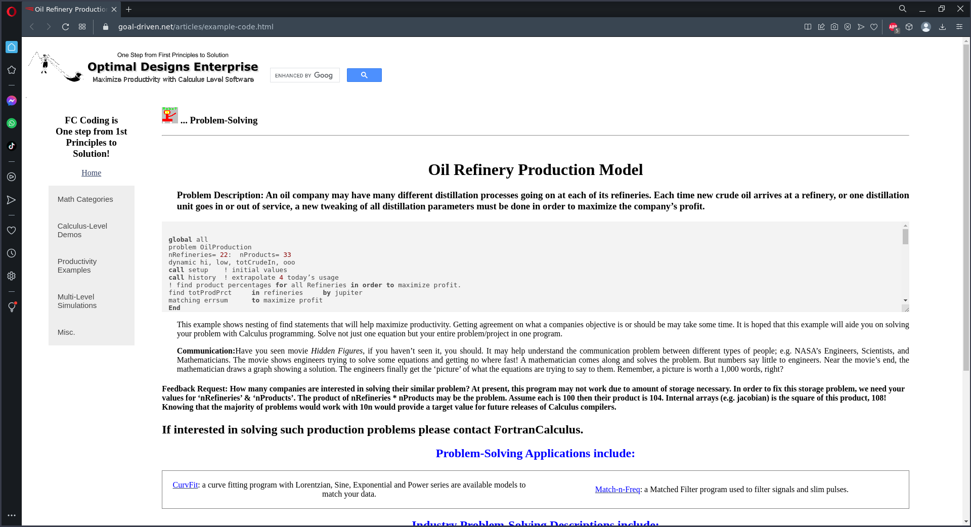

Hello again Phil! I got your last requirement covered:
Nice to let user drag height to what is best for them.
You will need to add the resize: vertical; style to the code tag, like this:
Code
<pre><code style="max-height:40em; resize: vertical;">
Anything else, just say it :Thmbsup:
