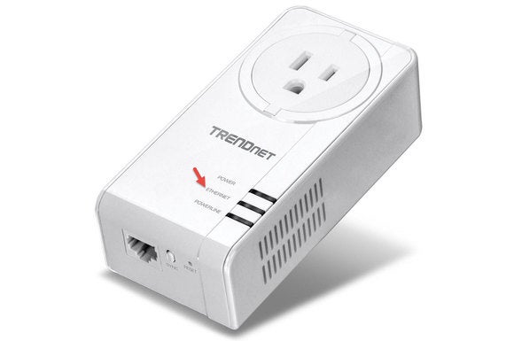

Has anyone ever come across a Raspberry Pi that has a pass-through power port, similar to the powerline networking devices?
So something that looks like this, but with a Raspberry Pi in it.
I can't give a lot of detail about what I'm up to, but I'd be needing something that is not a kit/homebuilt for the application in mind.
