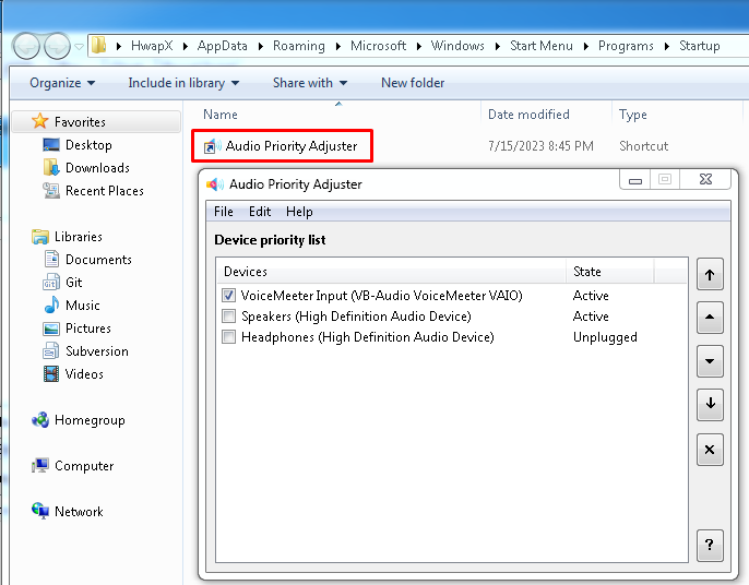

You are right about the tooltip, i changed the wrong place.
But the shortcut are correctly, see:
Try manually deleting it and recreating.
New version with the tooltip fixed: https://github.com/HwapX/dcAudioPriorityAdjuster/releases
Zero3K
  • Posts: 316
Thanks for fixing it.
