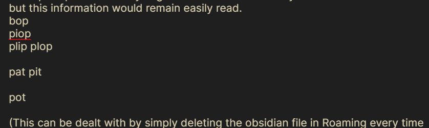

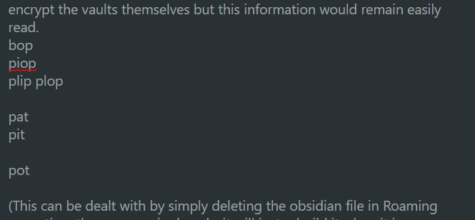

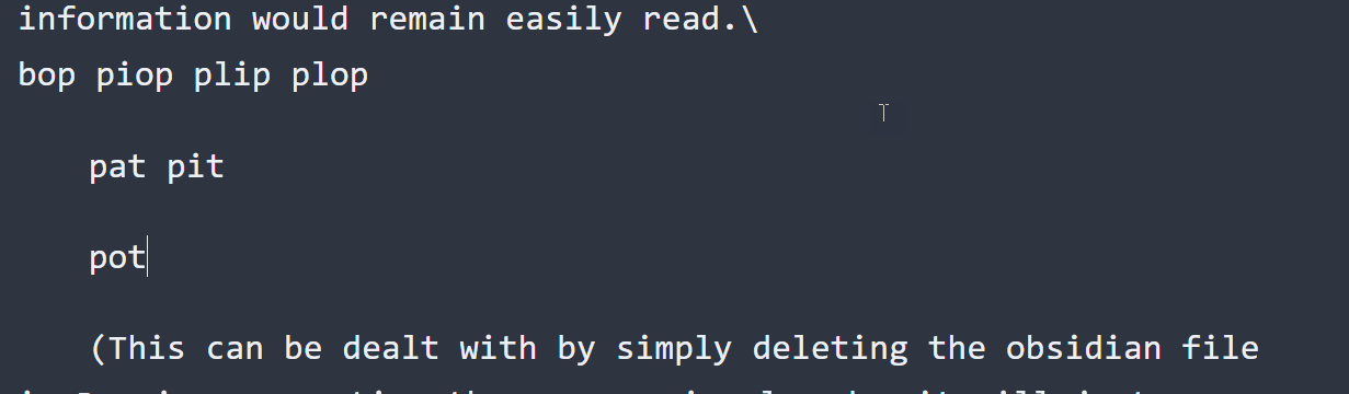

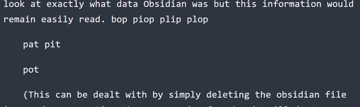

I have been developing a workflow that involves using OPML to move between markdown files and Dynalist/Workflowy, but I have hit a problem with exporting notes from both outliners. Paragraphs work perfectly, but single lines concatenate and sometimes produce a \ at the end. I have tried a number of converters including MarkText and Typora (which uses Pandoc), and the issues exist in each. The samples below are in Typora (Marktext has occasional issues where an extra line feed slips into the middle of a paragraph).
The simplest answer for me is to always use paragraph breaks. But I can't help wondering what is going on with line breaks and whether there is a simple, automated answer to the problem.

Typora import concatenates single lines.
MarkText import concatenates single lines.
As do online converters.

« Reply #3 on: January 03, 2022, 07:12 PM »

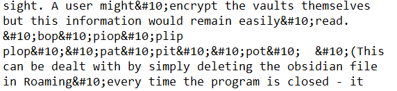

I don't understand OPML, but it seems to be a difference of opinion about a setting relating to single lines
I've narrowed it down to this character -
The OPML uses it to indicate new line. x2=new para
But Typora has no new lines, only new paragraphs. So x2 recognised, x1 disappears
This leaves me doubting whether there exists a lower friction solution than simply using paragraphs instead of lines.
