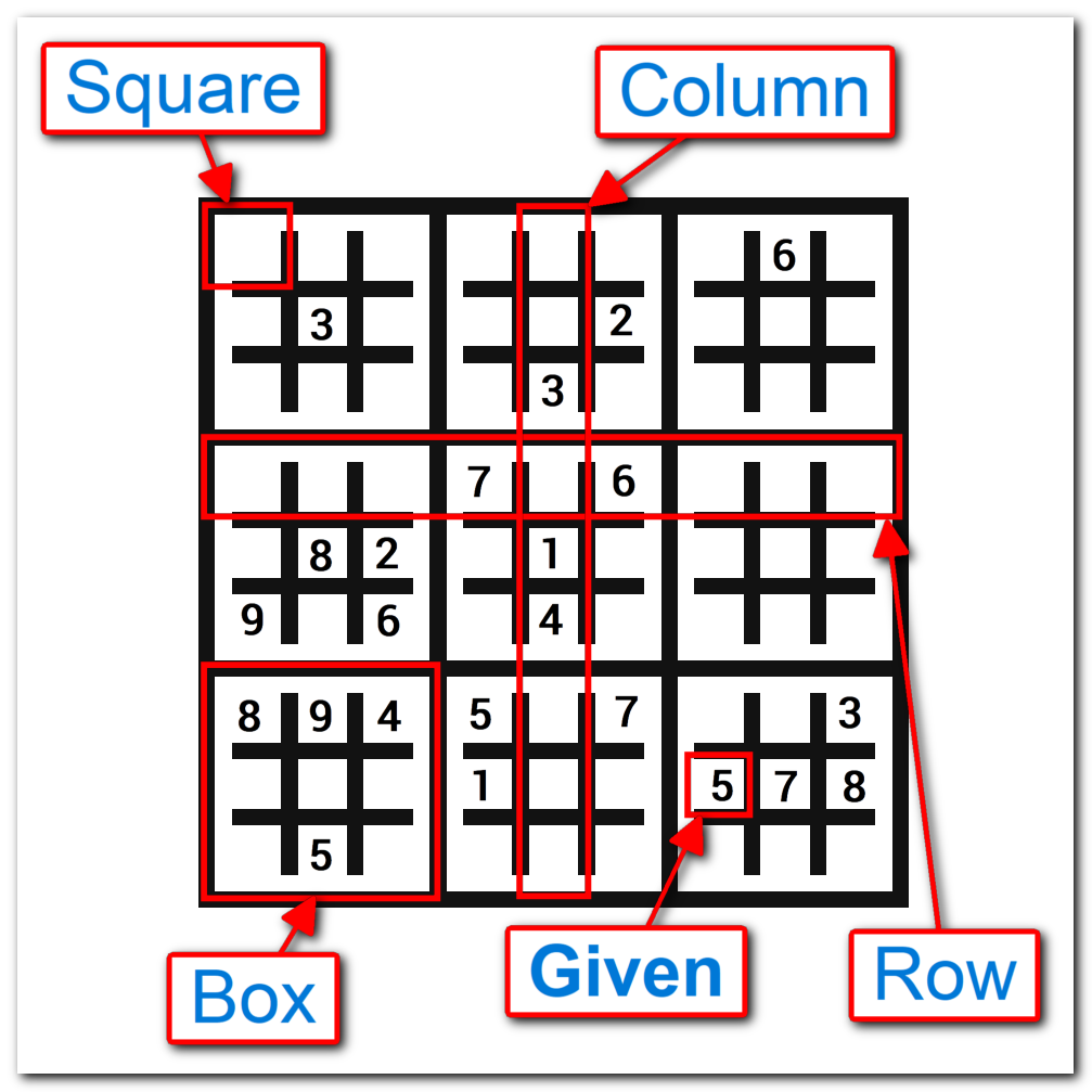

And here's a crude diagram showing a minimal puzzle with some of the above terminology highlighted:

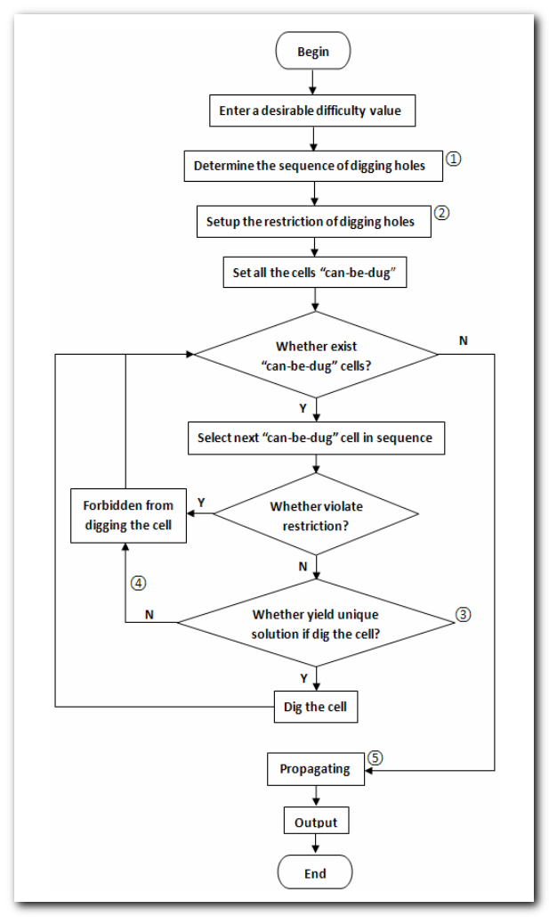

I then follow a method I read about in a paper called Sudoku Puzzles Generating: from Easy to Evil (link to archive, since original link is dead) which the authors refer to as "digging holes" in the puzzle, and offer this flowchart as part of their explanation:
I'll summarize my understanding and (attempted) implementation as follows:
  1. Order a list of all the squares to "dig" however you see fit. (I just shuffle an array of all the squares)
  2. For each square in the list, attempt to dig the known value N. This means to set the value as "unknown" or "empty" (represented internally by the number 0).
  3. With the newly dug square, attempt to solve the puzzle with all possible values (1-9) other than N.
  4. If you find a solution, it means the puzzle is no longer unique (it has multiple solutions), so the square is considered a given and must display the value N to maintain uniqueness.
  5. If you don't find a solution, the square can remain "dug" and you continue iterating the list to dig more holes.
  6. Once you've iterated the entire list, you should have dug out all squares that are not essential to maintaining the uniqueness of the puzzle, which results in a minimal puzzle.

As I understand the basic gist of the algorithm is that you incrementally blank out squares, and check to make sure (by running a solver) that there is still only a unique solution to the puzzle with the square blanked out.  If there are multiple solutions with that square blanked out, you must force it to be a given, and try looking for another square to blank out (dig a hole).
So, this algorithm guarantees that the puzzle, with its givens and its holes (blanks) is UNIQUELY SOLVABLE.
But it doesn't really guarantee that the puzzle is MINIMAL.  I don't think it claims to, does it?
It's not doing a brute force search for all POSSIBLE ways to dig holes.. It is in fact going through an ORDERED list of possible squares to dig, checking them one at a time, and when it finds one it can dig (leave blank), it makes it blank going forward.
This does not guarantee a minimal set of givens.  Depending on what holes (blanks) you decide on early, you may be forced into having more or less holes in the rest of the puzzle.
You could use it to find minimal puzzles if you ran it once for every possible sequence of potential holes, and kept the one that resulted in the fewest givens.
Does that make sense? Or am I missing something?
