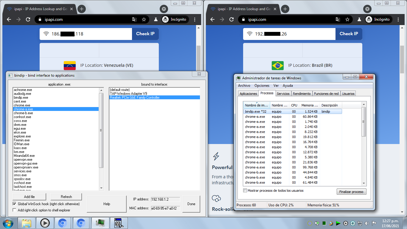

I found a way to do this properly with BindIP, as described by its author, it is a spiritual successor to ForceBindIP :D
https://github.com/katlogic/bindip
Works as a charm :D
